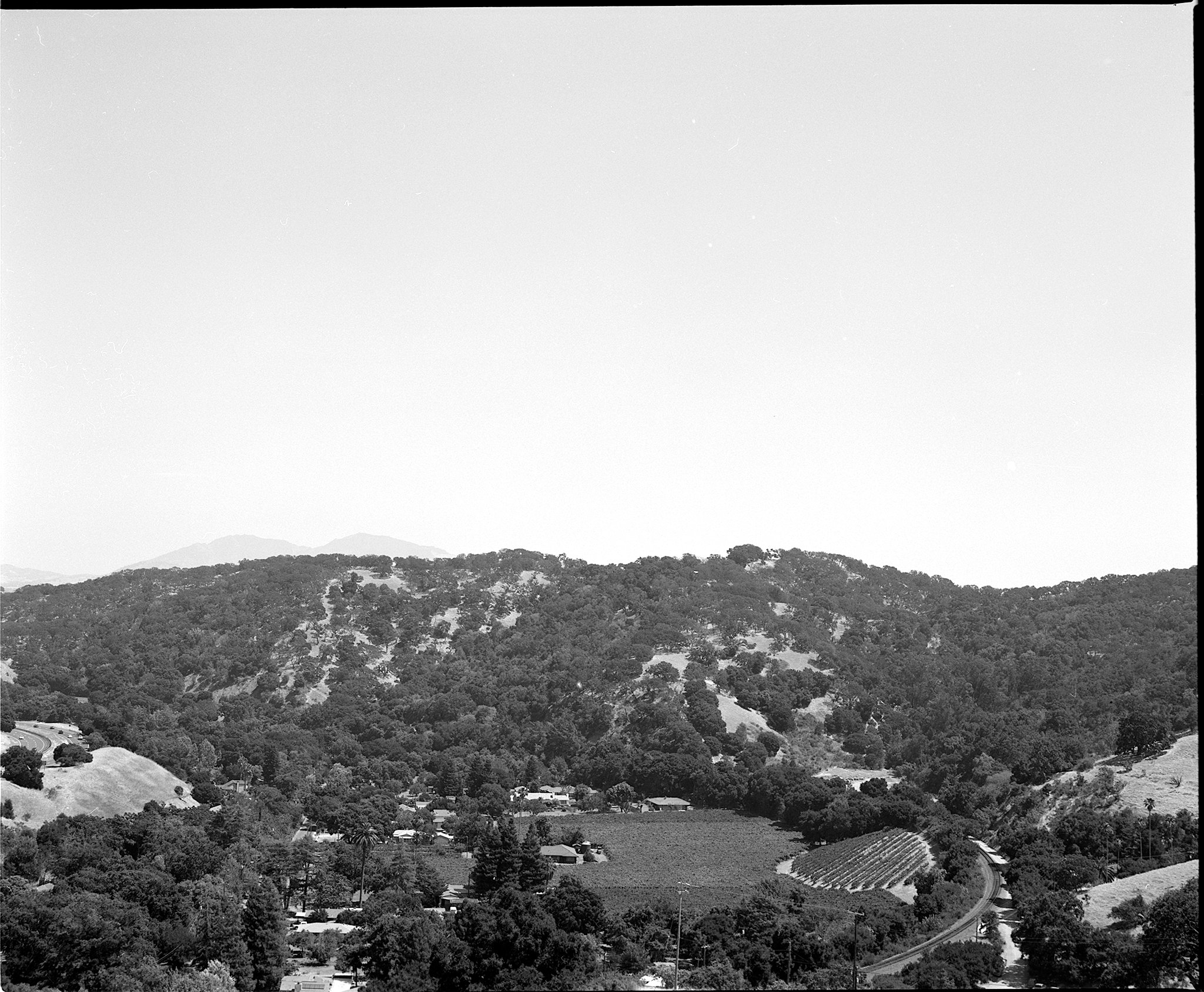

I recently received an RB67 from KEH and exposed a roll of film to test it. In some of the images on the roll (all of the same scene) it looks like what may be a light leak.
In the image, there's a lighter area that looks like a vertical bar about 1/4 of the way into the frame from the left hand edge. Of the ten negatives about 1/3 have this line and it's always in the same place. The only difference in the images is that they all were exposed at different shutter speeds (with the aperture changed to keep the exposure the same)--is it possible that the light leak is more visible on frames that had a longer exposure time?
I'm wondering if I should discuss this with KEH?

Check the foam in the back, the revolving adapter and the rear of the camera. I have had to replace mine in the past. Also the dark slide may be leaking. I haven't had that happen yet.

Post a picture of the full film strip including the rebate (area outside the image) so we can see if the leak extends beyond the frame.

Unfortunately, I cut the strip up into two exposure pieces to fit in the scanner. I checked the images on a light table with a loupe and for all but one image with the line there is no increased density in the rebate.
The one exception looks like below. The line goes across the image starting at exactly the point where the edge is dinged (physically damaged). I did have problems loading the reel when I developed this roll (due to not having done it in many years!) Can these lines be due to the film being loaded on the reel incorrectly? I'd think that if the film was touching itself at some point that would result in lower negative density at that point due to less developer reaching the film.

The attached picture with the dark marks - I assume those are dark on the negative - is weirdly sized, but assuming those are small crescent dark marks (sort of like a fingernail clipping), yes those can come from buckling the film as you load it on the reel. I don't think the straight line across the frame as in your first photo has anything to do with them.
I didn't mean that you should scan the rebate, but that often a picture as simple as a phone picture of the filmstrip against a light table, white monitor screen, etc is revealing. If the light leak stops at the edge of the image area, that means it is coming from in front of the film gate. So you can check the seating of the roll holder to the back, light seals of the back frame, etc, but you can probably rule out light seals in the back door /hinge of the roll holder. That kind of reasoning.
The attached picture with the dark marks are dark on the negative and it undoubtedly is the result of the film buckling during loading the developing reel. There is a white line in this frame through the picture area and it lines up exactly with the buckle mark on the edge of the film. The other two frames with definitive white lines through the picture area do not have this type of mark at the film edge, but I'm thinking the film jumped the track on the reel and the film was touching in one or two places. Unfortunately, I didn't check for this while the film was still on the reel after development was complete.
One puzzler is the fact that two of the frames that have the white line have them in different places in the frame. Both are landscape oriented frames and the first one has a vertical white line 1/4 of the way into the frame from the left edge and the second frame has a vertical white line almost dead center in the frame. If this was a light leak, wouldn't the position of the white line be consistent?
That makes sense. I looked closely at the seating of the roll holder and of the back itself and didn't see anything obvious. This RB67 and the back are both PRO-SD and I've been told it doesn't use foam light seals like earlier models did.
Could another possibility be not a leak per se but a shiny reflective area inside the camera body that reflects light onto the film when the shutter is open?

Straight lines in a vertical (right angles to the film length) orientation on an RB67 are most likely leaks in the film back hinge line, though possibly bad felt in the dark slide slot (this would usually be more spread out) or a leak at the latch (this would also usually be more spread and you'd be able to see that the latch wasn't closing correctly). The ones that are worse are probably an inch or so AFTER the frame that was in the gate when the film stood a little longer than the others.
As a test, put a piece of gaffer tape over the hinge after loading the back and before advancing to frame 1, then shoot a roll slowly with direct sun shining on the back hinge. If there is now no leak, a hinge leak is confirmed.
I'll give that a try. I plan to expose another roll this afternoon and develop it over the weekend. Last time I did this the camera was in complete shade while exposing the film. This time I'll put the camera in direct sun and see if that makes the issue, if it exists, more obvious.
Depending on the results of this test I'll speak with KEH on Monday and see if I can return the camera to them for repair or replacement. I purposely chose a camera from KEH in Ex+ condition rather than Ex or Bargain or Ugly condition on the hopes that what I got would not have functional issues, but it appears that KEH's rating system only covers cosmetic condition, not functional condition. To have caught this issue, they would have had to do a test with film, and I doubt they do that. I suppose buying any camera used is a crapshoot and this time I came up craps. 😥

I shot another roll of film today, alternating having the camera exposed to full sunlight and covered up to shield it from light.
To eliminate yet another variable, I’m having the local lab process the film. Then I can be sure that any strange lines on the negative are due to light leaks and not me bungling up the development.

Got the roll I had the local lab process back and the light leak, if it's there at all, isn't obvious. Looking at the negatives, and the JPG scans the lab provided, I don't see any smoking gun.
Here's an image I scanned from the negatives. This is probably the worse-case as far as showing any light leaks because the camera was in direct sun and the shutter was open the longest out of all of the exposures (f32 @1/8 second). Film, once again, is Ilford PanF Plus, this time unexpired (expiration date: 05/2024). I shot the roll the day before it was dropped off at the lab. They say they developed the film in Ilford ID-11.
The first roll I developed myself had no frame markings, but this one did. I suspect this is the infamous PanF Plus issue of the latent image disappearing if the film is not developed soon after manufacture.
Any comments? The sky doesn't has very little, if any, of the mottling the first roll had. I'm surprised that lab-processed film has as much dust and other gunk on it. I thoroughly cleaned the negative carrier glass and bed of the scanner and blew dust off the negative before scanning.
Anyone see any sign of a light leak?

I surely don't see any leaks. Rebates look good? If so, it may just have been age damage to the first roll.
My experience is that only the door hinges are really prone to leaks on the RB67 and its film backs, but I haven't used them that long.
