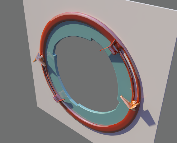

I presume you could make some sort of ring inside the 4x5's bellows that cocks the shutter and mechanically links to the outside:
attachment.php
Imagine that the blue area is the lens mount, which is of course static and attached directly to the white lensboard. The red ring is also static and attached to the lens board. (I'd suggest either precise MIG welds or some carefully drilled holes for screws). The yellow flanges, however, move along the tracks cut into the static red ring. These flanges interact with the two pins on the RB67 lens.

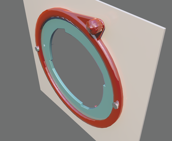

attachment.php
The outside ring behaves like any other leaf shutter, whereby it is cocked with a motion following its outer circumference. When this outer ring is turned, so too are the screws on either side of the ring. These screws attach to the yellow flanges inside, thus rotating them around the central axis and cocking the shutter.
Another option that probably involves less CNC, rather more scavenging for parts, would be to remove the elements and the shutter from the RB67 mount entirely. It would allow you to see if the native shutter could be cocked once it is removed from its housing, or perhaps if the elements screw into a standard #0 or #1 size.
Hopefully you find this helpful. Though it's only really a half-baked plan whipped up in 3dsMax a moment ago. Best of luck!
