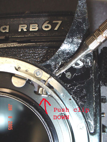

You can dismount the lens without damage easily, peel back the pleather on the upper right corner of the front, when looking at the camera head on, there will be a little hole, insert a paperclip to depress the latch and the ring will turn, allowing you to remove the lens.

I have peeled back the pleather, found the hole and inserted the paperclip. I have not been able to find the mechanism inside the hole to release the ring.

This problems is very common. The lens was put on without cocking the body n lens first. To unlock it you'll have to do the paper clip trick described earlier. DON'T FORCE ANYTHING! You'll do more damage to your camera if you do.
I've uploaded a picture of the clip so you can see exactly how it works sicne you are doing it blind n not familiar with the mechanism.

Hell yes. The diagram helped immensely, especially knowing how to curve the paperclip.
Thank you very, very much. The lens has now been removed.

Ok I found the hole on my body, but how can I reach the clip? This is very hard!
What does it feel like when you push it down?

Hey TimVance, I have the same problem.. I just can not seem to get my paperclip in the correct position to press the mechanism..

Take another look at the pic? As you turn the lens locking jam ring, press down on hte paper clip n the ring will pass the locking lever. Then it's a careful wiggle game to get the lens off.
It has a slight springy feel to it but doesn't stay down when pressed, it only allows you to pass stop in the lens lockring ring.... it's not a switch.
