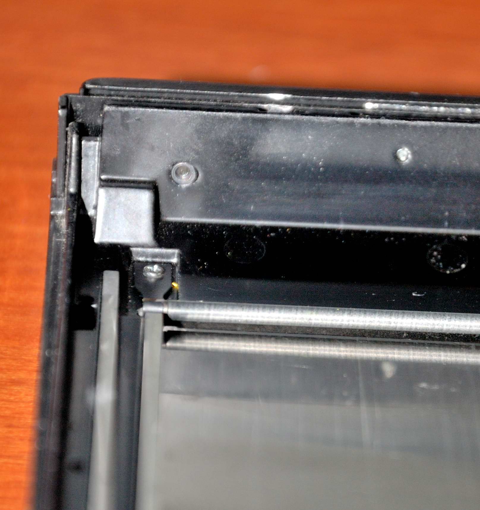

I'm wondering if someone can do me a favour? If you have a working rb67 120 back, can you open it up, and look at the rollers on the exterior casing, the ones that keep the film against the pressure plate. Please tell me if they are relatively flat against the exterior casing wall, or if they are extended up away from it. On my back one of the rollers is slightly elevated from the casing. I wonder if this could somehow be causing the scratching, having a roller edge dig in to the film slightly?

I'm looking at mine. A roller on the side where the winding lever is SLIGHTLY higher than the pressure plate. This is consistent in two backs (of Pro-S type) I have. I also checked one Pro-SD type. This one has both rollers slightly lower than the pressure plate on both side. I then checked my 6x8 power back. The lever side roller is higher than the pressure plate.

thanks Tkamiya. just to be clear you are talking about the tiny rollers on the exterior casing right? Not the big rollers on the interior, on either side of the pressure plate?

I'm talking about the latter. Wrong one by your definition. Sorry. Rechecking...

Here's the image.
The thin rollers are raised above the dark slide. This is consistent between two Pro-S type I have.

okay thanks. on one side mine is like that but on the other side it is a good 1-2mm further away from the dark slide on one end. I suspect that it might be what is causing the scratch.

I'm having hard time picturing (imagining) how this roller thingy can be that far off from the darkslide. On mine, it is held by a pair of black clips on both end which is screwed into the frame by tiny screws. Is your clip bent up? Is the rod bent? Does the roller actually "roll?"
That ought to be an easy fix, I think??
I'll be glad to take as many photograph of mine for comparison as you need to get you going....
