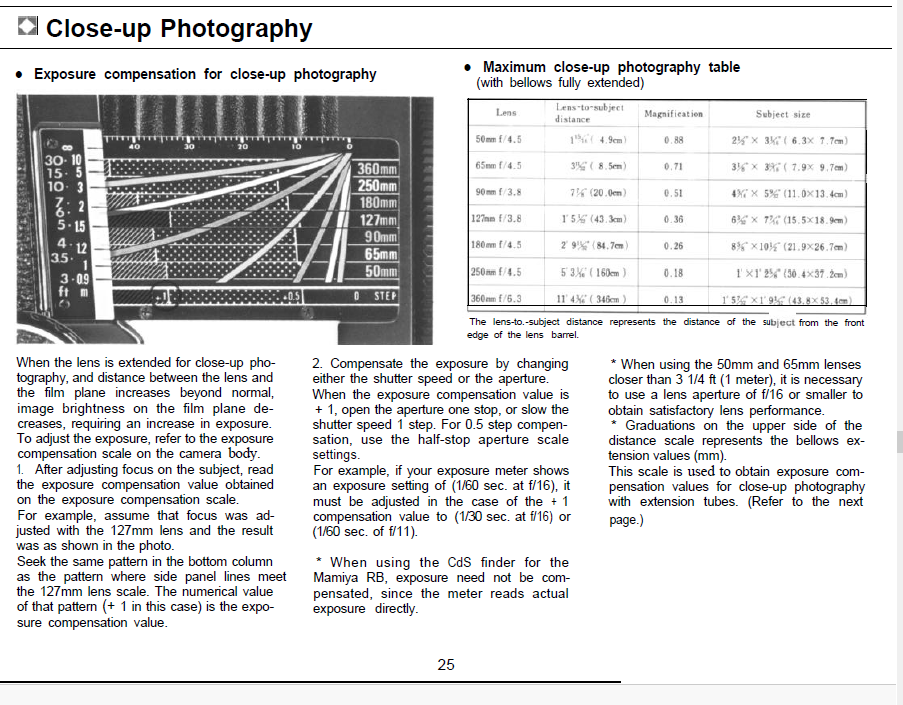

Unfortunately the booklet says nothing about how to calculate bellows extension. Simply go with the apperture value of the inserted disc and calculate normally?
bellows extennsion would be in the close-up section of the camera user manual.
There is a guide built into the side of the focusing mechanism - provided your camera has an entry for the 150mm focal length. Even without such an entry, interpolating between the 127mm and 180mm markings will probably work. Here is the page from the Pro-S manual:
As the original overthinking poster here, my sense is that the insertion of these discs into the light stream at the lens shares no relationship with any effects caused by the distance between lens and film. So my guess would be that the extended lens compensation recommendations remain as they would be with any of the other lenses. Use the scale as you normally would. (Thanks too to the later contributors to this thread)
