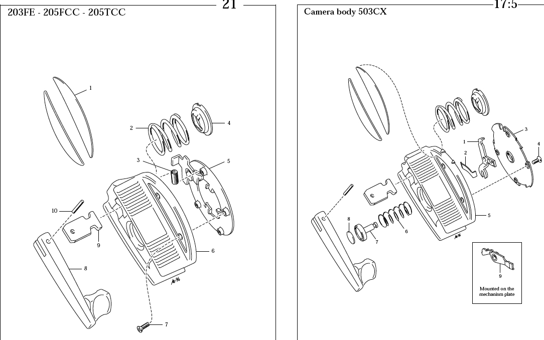

I am using Winder F's on my 205FCC and 203FE and want spare manual winder cranks as when the batteries die mid-wind on the motorized winder, one needs to take off the Winder F and use the hand crank to manually wind the shutter to reset it.
Doesthe 503CW or CXi rapid winder crank work on the 200 series as well?

I tried to solve this question in Hasselblad service manual 203-205 and 500-503. They looks in technical drawings the same, but I can not be 100% for shure.

I don't think so. Hasselblad calls the 200 series crank 'Winding Crank E' It has the button in the middle for double exposures. They are hard to find by themselves.
