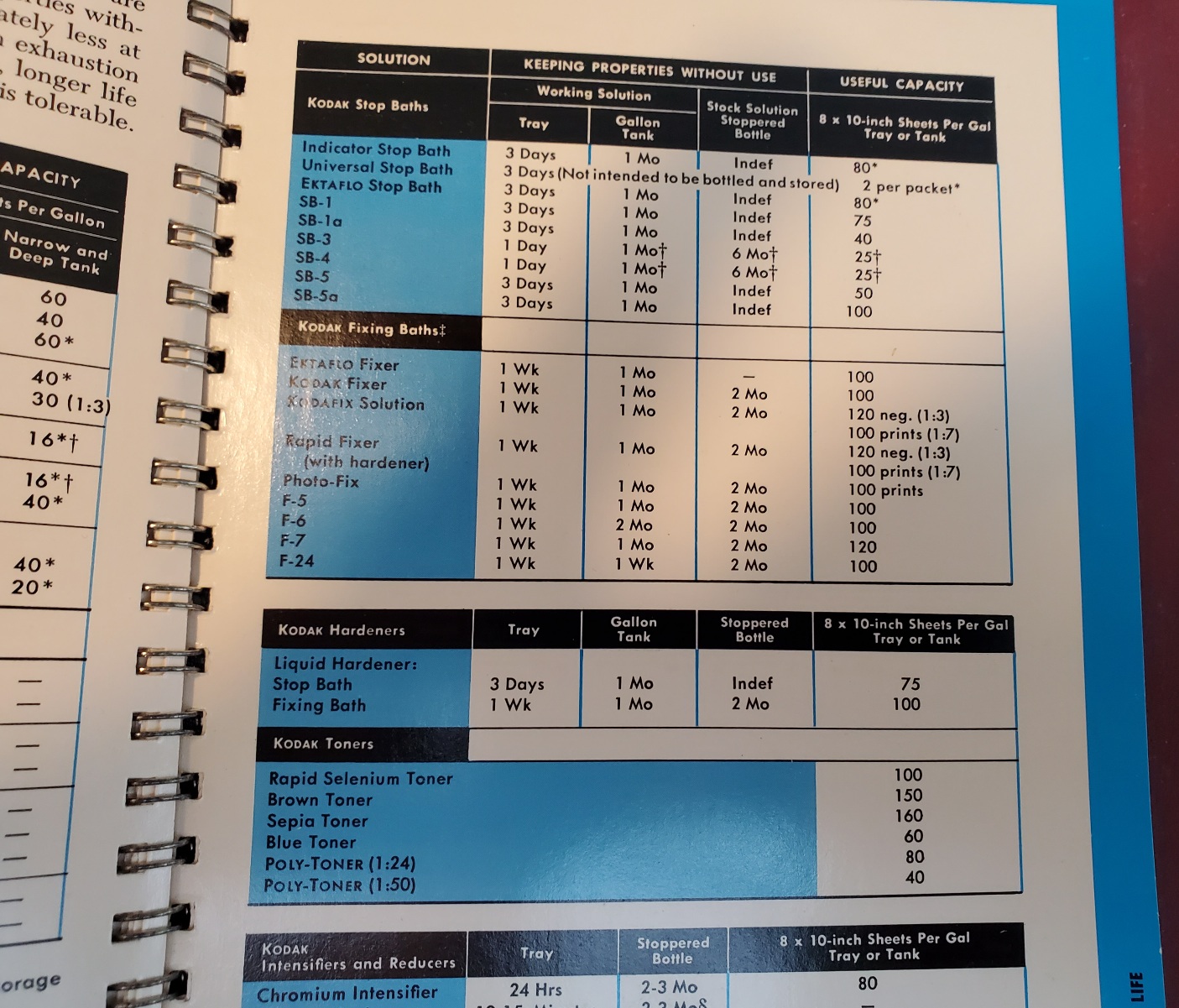

So using Kodak's rapid fix film strength you should (in theory) get 30 36 exposure rolls per quart (946mL)
Or using the Ilford Datasheet linked to above, and 1+4 strength, twenty-four 135-36 rolls per litre.
The Ilford Datasheet is a tad more recent than the Kodak Darkroom Dataguide shared by @mshchem :smile:.
