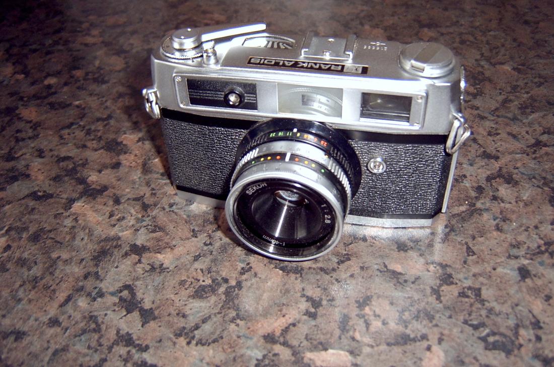

Anyone know anything about a Rank Aldis, I have just got one (my first RF) and am currently finding that if focus on something relatively close or medium distance then everything is fine but over a greater distance the vertical alignment seems to be slightly out. Is this normal and if not how can i resolve this.

Rank Aldis is a British company, but the only succesful google for such a camera led me to something described as 'made in korea' with a sekor lens...?
Confused!
A sekors lens should mean a Mamiya camera. Maybe someone was playing games with re-branding when importing /exporting. Is the camera maybe a Mamiya 35?
Can you post a pic?

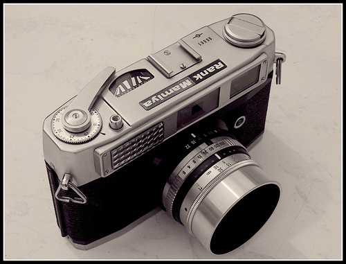

your camera is a re-badged Mamiya 4B, they came in quite a few flavours, early versions made entirely in Japan, later ones with Japanese lens & Korean body. Some of the later ones had a cds light meter, instead of the selenium one fitted originally. In general, those intended for the British market had a Mamiya Sekor lens, those for the USA a Mamiya Kominar, either version being f2.8/40mm in a Seikosha shutter, 1/4sec-1/250+B.
To adjust the vertical alignment of the rangefinder, remove the two screws holding the accessory shoe and remove it, revealing a hole in the top cover 2.5mm dia. Beneath this hole is a slot headed screw, which is central in a wedge device; insert an appropriate sized screwdriver, engage the slot, and turn gently whilst looking through the viewfinder. Try this at different distance settings, although in my experience there is rarely any difference, and when content, replace the accessory shoe, it's as simple as that!
If, after carrying out this adjustment, you feel the need to adjust the horizontal alignment, remove the four screws retaining the upper viewfinder bezel, and remove this complete with glass. You will see a vertical plate to the right of the lens, and this has two screws, the right hand one is used to alter the alignment. Only tiny alterations to this screw will result in dramatic changes in alignment, so go carefully, there is plenty of online info about the methodology of rangefinder alignment, or just use your intuition. Re-assembly is the reverse.

'fraid I can't really help you with the lens problem, except to say that I also have two of these, one restored, and another bought as a parts donor, and this camera has a very sloppy front element, much as you describe, the other silky smooth.
The difference is so great that I refuse to ascribe this to wear alone, and I imagine there will be some means of adjusting the fit. The camera that's restored has evidently had the lens board removed at some time, because the leatherette covering had been lifted and poorly replaced (there are four countersunk screws holding it in place, visible when the covering material is peeled back), and it's possible that this was done to correct the sloppy fit, and if so, it worked!
The bottom plate will need to be removed in order to disconnect the shutter cocking arm before removing the lens panel, so this is not for the faint hearted! I'll try and have a look for you, but it won't be until the middle of next week. Here's a link (I hope!) to some pics of the decent one:

Just to provide you with what has been requested, a pic of the camera below.
Thanks,
Andrew
