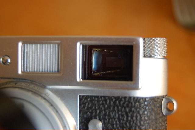

I am in the market for a Leica M2. So far one of the candidates' description states that looking at the front part of the rangefinder it's possible to see some yellow golden lines at the edges, reminiscent of elements separation. Sometime ago I read somewhere that it's not advisable to purchase a Leica with the beginning of separation specifically in the rangefinder. I am not sure if this is the case in this specific camera.
The seller says that this is a common characteristic with Leica M2s and that doesn't present any problem. Are this the words of an unscrupulous seller or the words of experience?

The golden droplets you describe are the beginning of balsam separation, and an M2 displaying this should sell for less. The camera can go on working just fine for years and years with no deterioration, or the prism can separate resulting in a blacked out view—a sharp impact can cause the prism to fail. But there is no real predicting how stable the viewfinder will be over time.
There is at least one repair person who will glue a fully separated prism in an M2 with a modern adhesive, Youxin Ye.

An M2 viewfinder with the golden droplets, beginning of viewfinder prism separation.

"The camera has been recently CLAd by Youxin Ye, and probably the owner didn't want to spend the extra money to re-cement the prism."
If the prism has not yet failed, Youxin does not force the separation, as this would be risky, and the prism may perform with a perfectly good view for years and years.
