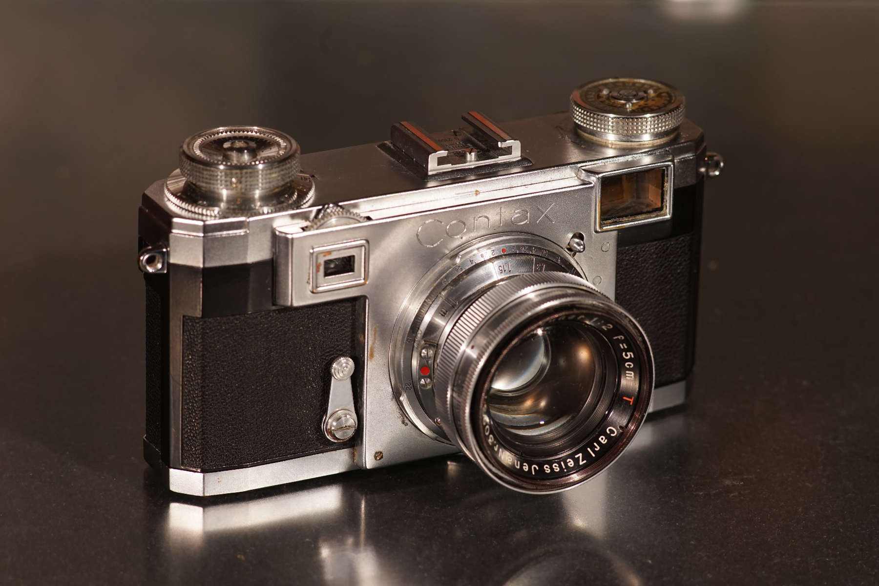

Today, the viewfinder Contax is in a different, less noble league than the Leica M. Period.
However, if you compare the aforementioned second-hand market prices, the Contax no longer looks quite so bad: It costs only about a quarter of a comparably equipped Leica M.
So if you are travelling with an M3 and a normal lens, you can add the complete five-part Zeiss lens scale from 21 to 135 mm to your bag for the same money. Possibly even a second body if you want to shoot colour and black and white in parallel or take several film speeds/development modes with you.
So the price/performance ratio is not bad at all.

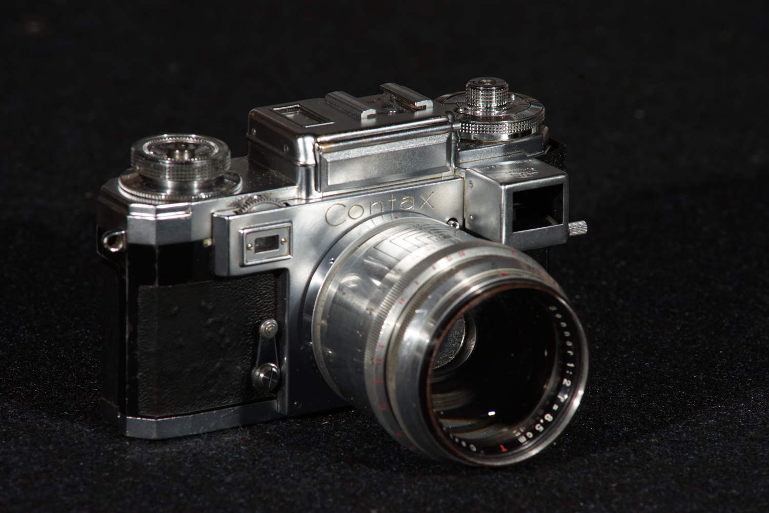

A shot of camera history: Which Contax should I choose?
The spring trade fair in Leipzig, Germany in 1936 is our starting point. It was there that Zeiss Ikon managed to turn its false start with the Contax (I) 1932 into an international success. If you like, you can read Hans-Jürgen Kuc's German book Auf den Spuren der Contax I (In the footsteps of the Contax I) to find out how many faults the immature Contax (I) had. That's why this original model is probably best suited to the display case of intrepid collectors today.

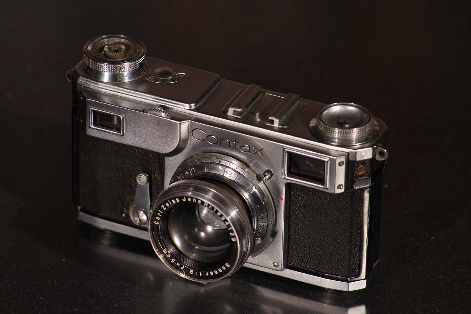

In 1935/36, the camera was thoroughly reworked and the Contax II was born: finally a real competitor for the Barnack Leica. A competitor which was ahead in some respects: Speed thanks to the world's first rangefinder, a scale of fast Zeiss Sonnars, a simpler film loading system, more precise distance measurement, advance mechanism, one-button setting of all time, and as an advertising gimmick also the somewhat faster shutter - after all, its metal construction made it insensitive to the sun's rays, which were so fond of burning holes in the Leica's blanket blinds.
Shortly afterwards, Zeiss Ikon followed up with the Contax III, which was one of the first cameras with a built-in light meter.
With such an 88 year old Contax II (or a III of the same age) you can still take excellent photographs today, but they leave something to be desired in the B-grade: the shutter speed adjustment is somewhat laborious, and above all: their shutter makes as much noise as that of a loud 35 mm SLR. At slow shutter speeds from 1/10 sec. it is even louder.
Therefore, if in doubt, the post-war IIa and IIIa models should be used. In terms of handling, they are not so different from their predecessors, but the time adjustment is much less effortful - and above all they have whisper-quiet shutters.
In this respect, we compared my Contax IIa with the well-functioning Leica M2 of an old friend: The quieter one was - the Contax.
In addition, the post-war models were somewhat smaller and lighter. They only seem to have a catch in one detail - and that brings us to the subject of ‘Contax peculiarities’.
Take care when carrying: Eveready case required
As the Californian Contax expert Henry Scherer explains on his very informative webside, the attachment of the strap eyelets in the post-war bodies was somewhat flimsy. Today we can only speculate as to whether a bit of post-war shortages may have played a part in this. Mr Scherer's criticism is, of course, controversial, but I didn't feel like making an attempt myself.
In any case, the way out is as simple as it is recommendable: only carry the camera in its eveready case. Typical of the time, leather straps are attached to the case. If you don't really trust these straps after 70 years, you can have them replaced in a leather workshop.
The cases themselves are sturdy and well made from solid materials (as was usual for cameras in this price range at the time) and can still withstand normal use today. The front flap cannot be removed (unlike on the Exakta, for example), but you have to live with that.
If you look very closely, you can see a difference between the cases for the Contax IIa and IIIa: the case for the IIIa is a few millimetres higher to accommodate the built-in light meter. With my IIIa, however, I have tried out that it also fits in the smaller case.
One small drawback is that the cameras really only fit into the closed post-war cases with the normal lens. And with the exception of the retractable lenses, the maximum that will fit is a filter, so the lens cap has to be left off. The case for the (pre-war) Contax II is somewhat more generously dimensioned: The II fits in there even with a 35 mm wide-angle lens attached.
Incidentally, the cases are not mutually compatible: the post-war body is shaped differently to the pre-war camera and is somewhat smaller.

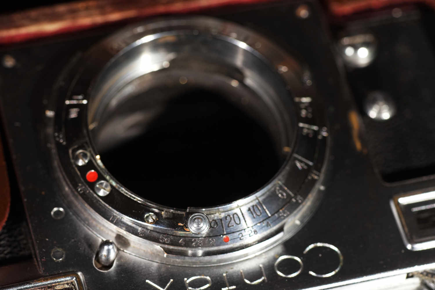

The bayonet mount and the issue of ‘speed’
It's a bit unusual for Barnack Leica photographers who screw in their lenses: the Contax mounts its lenses via a bayonet - a double bayonet to be precise. The inner section is intended for standard lenses. They therefore do not have a helical mount, which is located in the camera bayonet. The distance is adjusted either by turning the lens as usual or by using the small wheel that should be under the middle finger of the right hand.
In the 1930s, this was considered particularly suitable for snapshots: you set the distance with your right middle finger and release the shutter with your index finger.
Sometimes people on the web wonder why this wheel had a locking function in the infinity position (which is released as soon as you put your middle finger on the wheel and automatically press down the small lock next to it). However, this is necessary in order to be able to comfortably remove the standard lens after releasing the bayonet lock.
The external bayonet accepts all other lenses. A small lever automatically releases the locking mechanism of the distance wheel.
Before attaching one of these lenses, the inner bayonet should be set to infinity (this is another reason why the distance wheel on the housing is locked in this position). After attaching the lens, set the distance ring of the lens to infinity if you have not already done so. The coupling of the lens distance ring with the rangefinder mechanism then engages in the housing with a quiet but rich metallic ‘smack’.

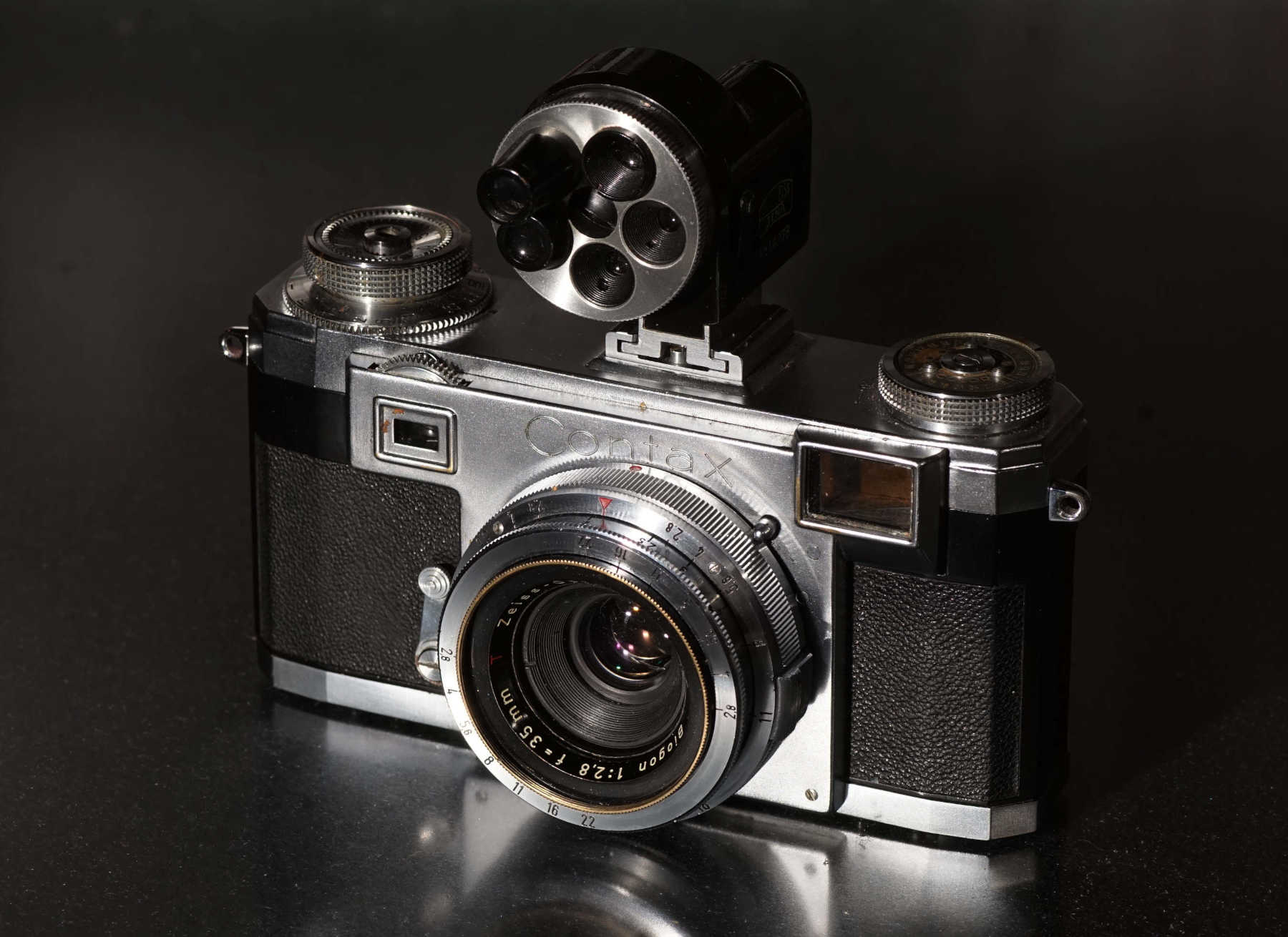

The viewfinder system
Here we come to the decisive point in which the Contax cannot keep up with the Leica M. With the rangefinder, we are looking at a device that was state of the art in the mid-1930s and still quite usable in the early 1950s - but the Leica M ushered in a new era for professionals in 1954.

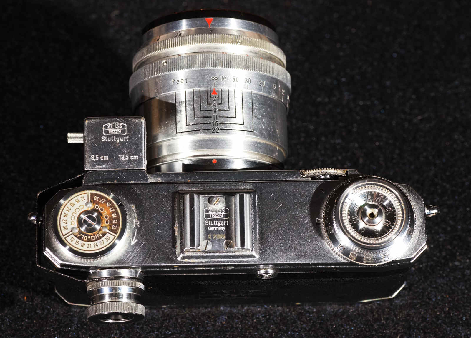

Like the screw-mount Leica, the Contax did not yet have variable light frames for different focal lengths. You have to learn to live with that - but there are good aids.
First and foremost, I'd recommend the so-called universal clip-on viewfinder. It is constructed according to a kind of turret principle and - this is the highlight - always offers a viewfinder image of the same size, similar to the SLR, regardless of whether you attach a wide-angle, normal or telephoto lens. In other words, a different principle to the mirrored illuminated frames of the Leica M.
Zeiss Ikon introduced the universal viewfinder back in the 1930s, and these old viewfinders are still very usable today. If you want to save money, you can also fall back on Soviet ‘KMZ’ replicas. In the hope that they are precisely centred.
Of course, this means that you have to allow for greater parallax and adjust the focal lengths manually. To measure and adjust the distance, you have to switch to the camera's own rangefinder, then back to the clip-on viewfinder. The parallax compensation for short distances has to be adjusted manually on the clip-on viewfinder. But all this was no better 75 years ago.
In addition, Zeiss Ikon offered other types of clip-on viewfinders; however, some of these seem to me to be less useful in practice. If you disregard the really special systems for special lenses: the 21 mm Biogon, which was a sensation in the 1950s, and the 180 mm Olympia Sonnar, which (as already mentioned) opened up new dimensions for sports photography around the 1936 Olympic Games.
Today, however, the Contax version of this Sonnar is more for collectors than for photographers: rare and expensive; the version most commonly produced at the time required a highly rudimentary mirror box. And in general, I ask myself whether you are not better off with an SLR at 180 mm than with a rangefinder camera. Especially as somewhat more recent M42 versions from Jena cost only a tiny fraction of an optically comparable old Contax Sonnar.
This viewfinder attachment for the rangefinder is also not very comfortable: it is definitely not suitable for spectacle wearers and also takes some getting used to for those without glasses, as the viewfinder image is relatively small. In practice, a small square mask is placed in front of the viewfinder window, which limits the image section for either 85 or 135 mm; the image is therefore even smaller than the image for the standard lens. In addition, the viewfinder contains a parallax compensation in the form of a very small viewing hole that can be adjusted manually. With a 1a-clean and bright Contax viewfinder, this attachment is perhaps halfway usable on a bright day - but even then I would always prefer the universal viewfinder.
