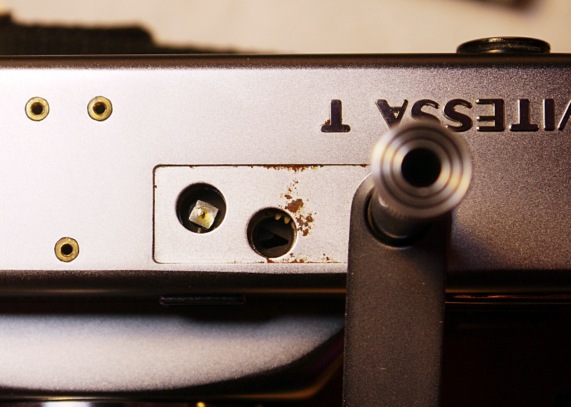

I removed the shoe so I could remove the plate as seen in the image. The hole on the left has a square nut. Can anybody confirm whether or not this is the rangefinder horizontal adjustment? It does move when racking the focus back and forth.. There is no adjustment screw/etc in the right side hole but the part visible also moves..

Quite by accident I ran across this http://www.kyphoto.com/classics/vitessarf.html It might be helpful, although the site confirms my earlier impression of the adjustment as a horror show. Please share your impressions of working on the L after the tranquilizers kick in.:smile:
