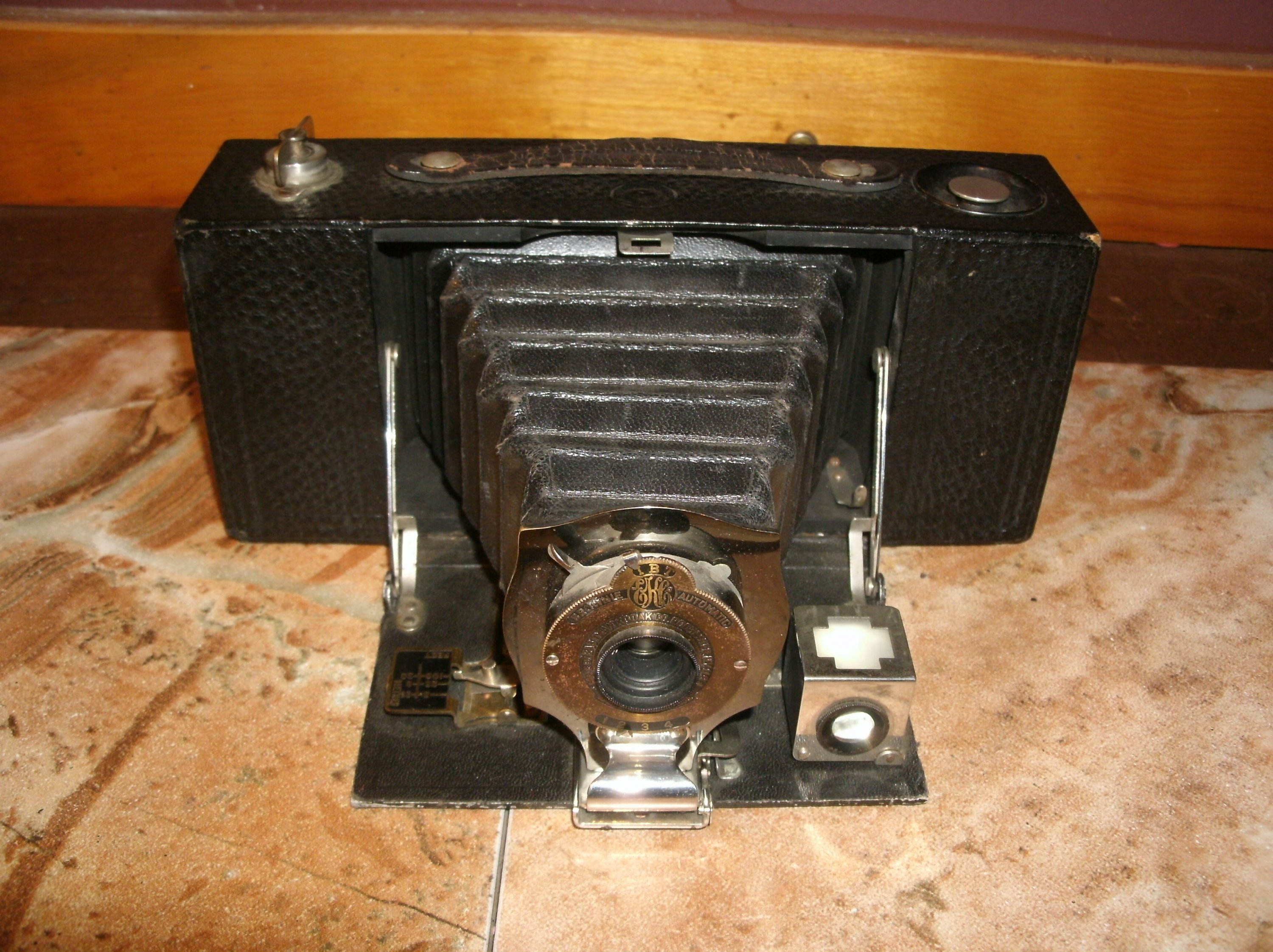

Hawk-Eye No.2 Model B, as found years ago, in the attic of my previous house.
I had all but forgotten about it, but pulled it out for a minor inspection.
References say the 2A made 2-1/2 x 4-1/4 inch images on 116 film (which was 70 mm wide).
I have only one wooden spool.
A few questions:
There are kits (plastic spool ends) making a 120 spool fit in the slightly larger 116 body spacing.
Is this reliable? Better homemade solutions?
Will the frame count imprint on the typical 120 backing be there for the 2 1/2 by 4 1/4 frame?
The body back red frame window seems to be at the extreme edge of the film backing.
What was the typical fixed shutter speed of the day?
I am assuming I would need ISO 400 film, here.
If I get this camera running, in addition to my newly-found Super Ricohflex, I would be stepping right into vintage MF, with zero experience. Hmm... sounds fun!
When I look at this Hawk-Eye, I get this urge to build a larger version for contact prints.
Already peeking at paper holder cartridge designs! Sick.

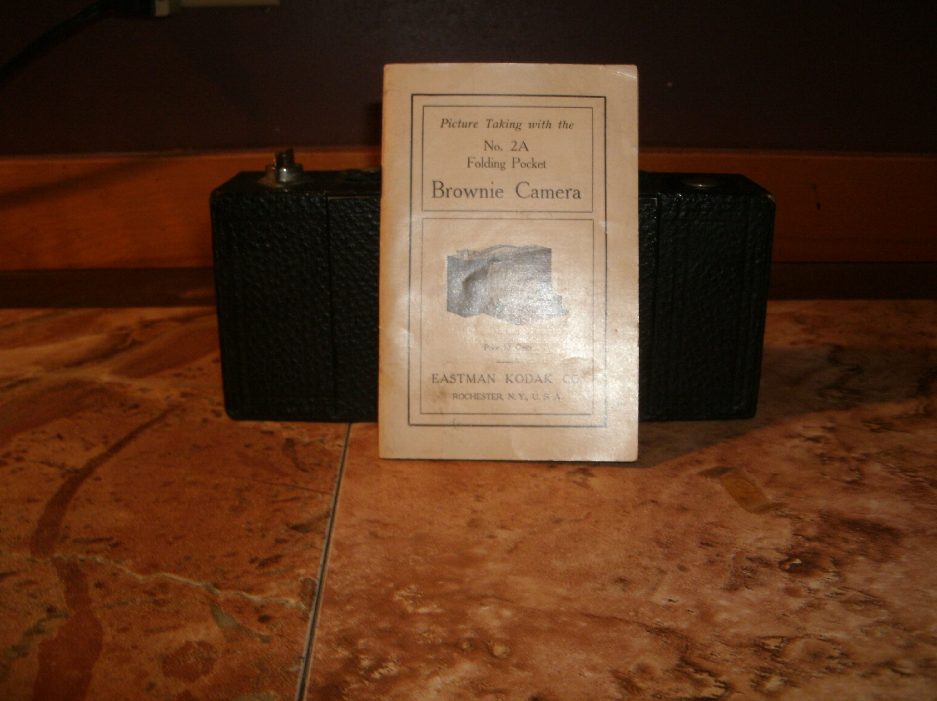

I have a more modern 116 spool and backing paper, inside a Brownie No 2A folder that's functional.
View attachment 225631 View attachment 225632

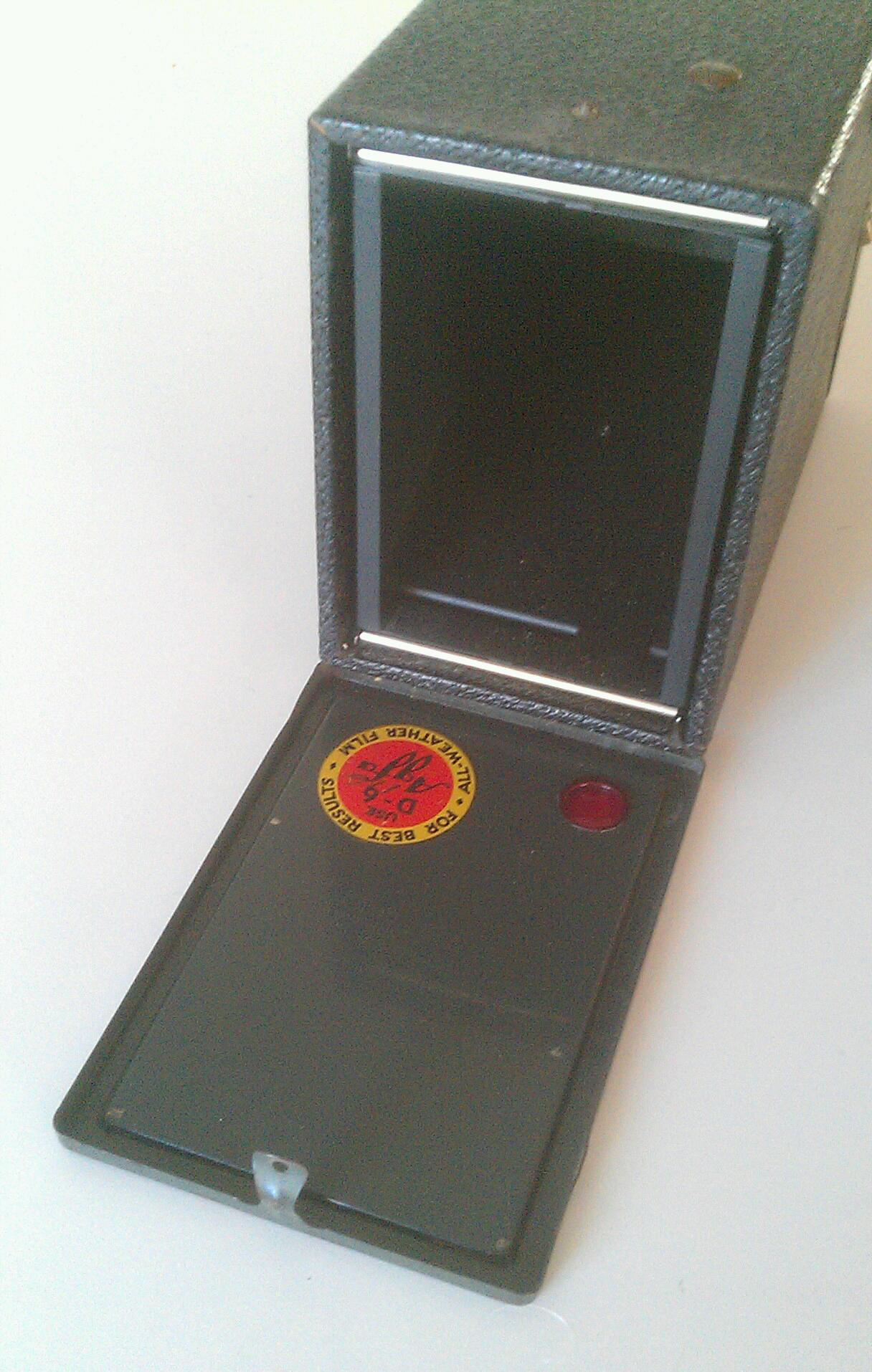

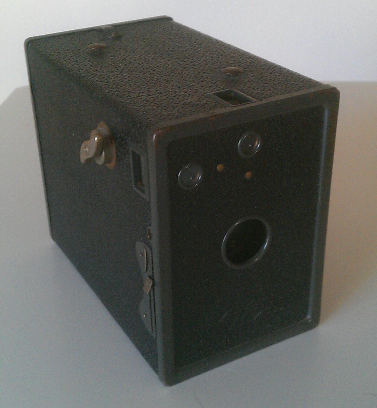

This is the Agfa camera my family used for hundreds of photos before I was born. It takes D-6 (116) film. I have only one spool.
Thank you for the framing info.
