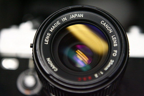

I bought my brother's Canon F-1n yesterday along with a couple of lenses, one of them being a '70s vintage 35 f2 which I guess went head to head with the legendary Nikkor O 35 f2 lens.
Small challenge, one of the elements yellowed, did Canon use any rare earth glass like Pentax did with their 50 f1.4 and can the same UV exposure trick get rid of the yellow? I shoot black and white about 80% of the time but I would prefer a more colour neutral glass.

The original Canon FD 35mm f/2.0 SSC with a concave front element indeed has a thorium element. Most people put it in the sun for a while to bleach it out. I leave mine yellow since I like the effect in B&W as a subtle yellow filter, often enhanced with a #8 filter.

I have done a lot of research to find out if there is any danger from owning a Thorium lens, and so has one of my sons who is a physicist on my behalf, and as far as we can tell there's extremely little, only a tiny fraction of the radiation level that is permissible for workers in the nuclear industry.

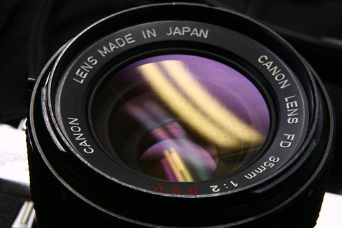

I've tested the Thorium lens against the new type FD f2 and find the reverse but the difference to be too small to be significant for practical purposes, I've also tested the FDn 35mm f2.8 which is also a very fine performer.
There were 3 FD lenses of the type 35/2.5:
no marking (possibly with chromed front bayonet), concave front lens, 1971
SSC marked, black front bayonet, concave front lens, 1973
SSC marked, black front bayonet, re-designed optics, convex front lens, 1976
New FD-bayonet, black front bayonet, re-designed optics, convex front lens, 1979
So, I guess you all are talking about the first two ones concerning that radioactive issue.
