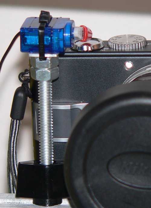

You would probably have to rig up something like this yourself with a servo and radio unit. Most modern film cameras wireless remotes are infrared, so if not in the line of sight, one would need to rig up something like this even with a modern camera.
