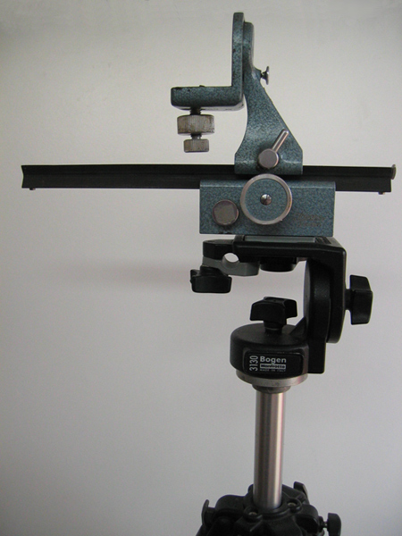

I posted an image of the Linhof macro rail here--
That's the current version, which is less common than the older version that is usually tan with white knobs.
I like that a lot David. It may be exactly what I need.
