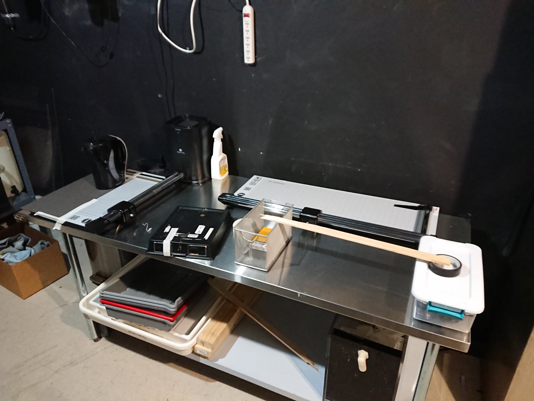

The pro labs do it with automated XY (both dimensions) computerized cutters. These are expensive and seem to have maintenance issues, but they cut cleanly. Cheap warehouse roll paper cutters, intended for various roll widths of Kraft and butcher paper, would seem to be quite inappropriate for photographic paper use. They're messy enough just with ordinary wrapping paper.
Guillotine style cutters can be used for cleanly cutting photo paper; but you'd want to count your fingers when the lights go back on! Dahle makes several quality grades of them.
I have a couple of Rotatrim dual-rail pro cutters. These are safe to use in the dark. One of them is 48 inch width, which I have mounted flush to a large laminated table surface equipped with a precise 90-degree angle stop, as well as with a precision positional length bar stop. A manual feed roller system sits just beneath the front of the table. I'll admit it could be tricky cutting down big 40 inch wide rolls of Cibachrome and various Fuji papers in the dark; but that's how I did it, and will keep doing it. It sure beats a box knife on the floor!
I have a variety of light-tight paper safes nearby, up to 30X40 inch capacity. The remainder of the big roll gets wrapped back up in its light-tight packaging, which is put back into its original box until I need to cut more of it down.

I've used three systems, personally:
1: A regular rotary cutter (Dahle etc.) lined up with a DIY jig that held the roll and a bar (length of wood) taped to the table by means of a stop to get the right length. This worked OK and I could build it from scraps.
2: Basically the same concept, but a commercial product that was made in probably the 1980s or so; this was essentially a box with a spindle on one end that the paper roll went onto, a guide in the middle and a roller cutter at the other end.
3: A proper paper dispenser, which is essentially a metal, light-proof box that the paper sits in with a motor that feeds the paper through a slit to the outside world at the set length, and a (manually operated) roller cutter.
The paper dispensers as mentioned in #3 used to be common in photo labs, but most of them have been scrapped. They pop up very rarely on the market, so it doesn't make a whole lot of sense to wait for one comes around.
