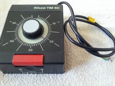

This seems to be a contentious issue, many people say it doesn't work? On the subject, my time dial on my enlarger timer (http://i.ebayimg.com/00/s/MTIwMFgxNjAw/z/evkAAOSw6n5XsLi4/$_1.JPG) glows green, would this cause any problems?
When I started colour printing, I was told that the safelights are so dim that they're not worth using, so I never bothered. Others on this forum say that you can have a quite useful amount of light provided you are careful with your choice of safelight, its placement and the length of time that the paper is exposed to the light. I can only recommend that you consider all the information you can can find here and elsewhere and decide for yourself. Working in the dark is not that difficult once you're used to it and have established an easily repeatable method, which includes placing everything where you can easily find it. I definitely would avoid using the timer, unless you can somehow shield off the glow.
It's very faint glow so I'll probably just place it on the shelf below the enlarger, hope that'll be catious enough
