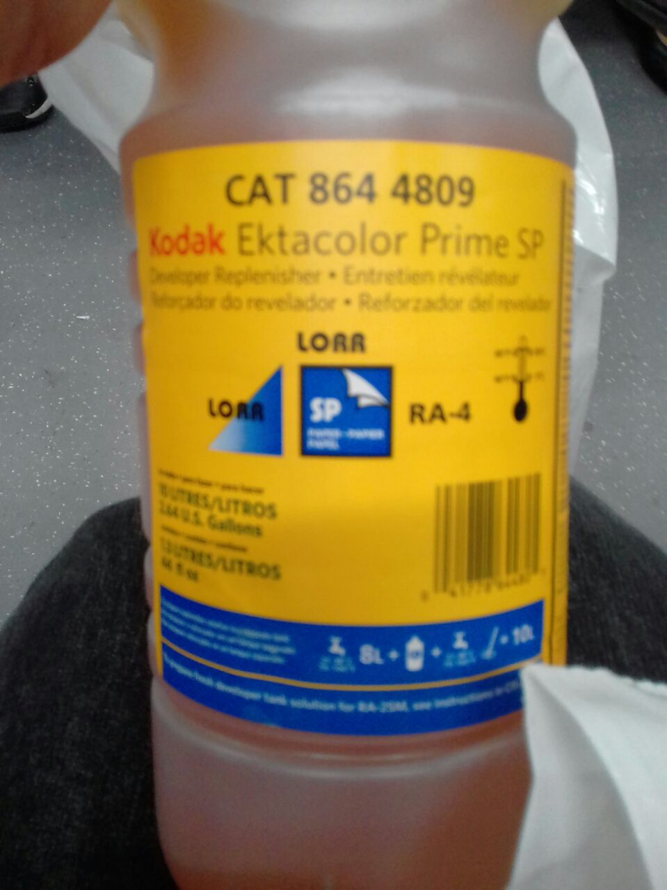

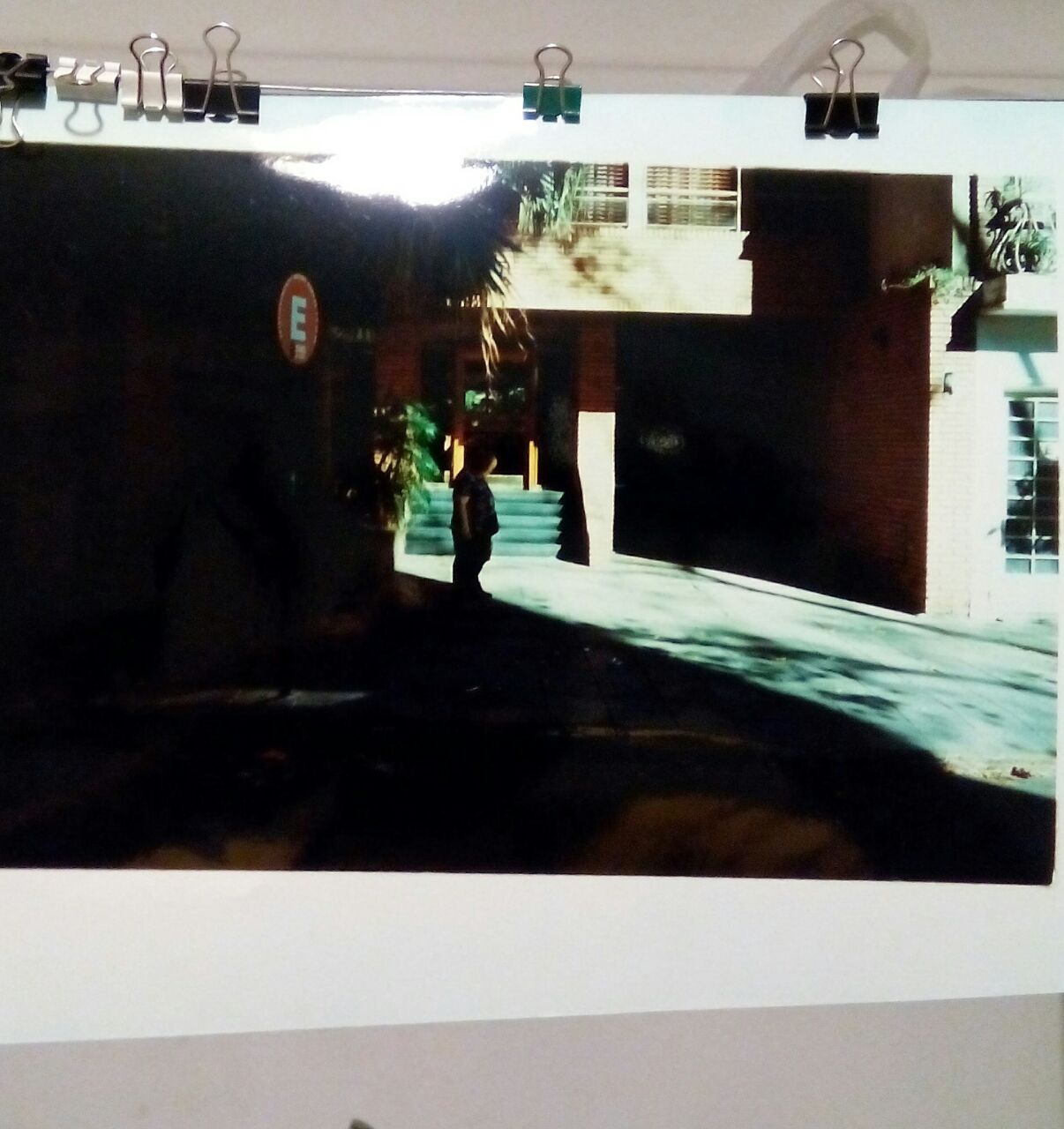

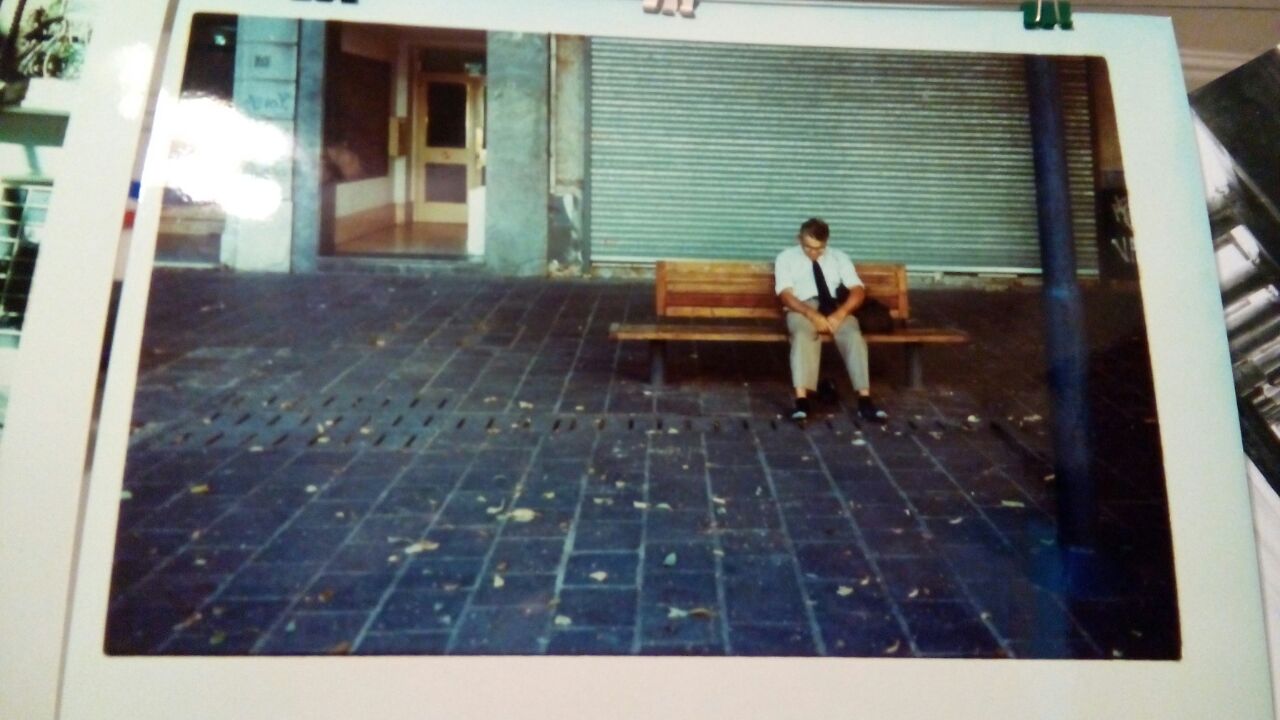

Greetings from Argentina. I have the following problem, I am developing RA4 with an AT job, and the chemicals I am using are:
kodak lorr sp developer for paper: 45 sec
stop solution: 1 min
washed
blix kodak 1 + 1 solution: 1 min
the problem is as follows, the first copies come out white at the edges, but some applications begin to emerge green on the edges of lso cut papers.
The paper I am using is kodak endura coil of 80 meters.
Also buy a first RT kodak that comes in 3 parts to try as well.
Coming soon upload photos of the photos xD

Borders appear white while images become greenish. Either one of two problems I guess without enough information....
1. Blix in developer
2. Exhaustion of developer if not single use.
PE

thanks, I'm going to try changing the developer and the blix, or replenisher with new developer
