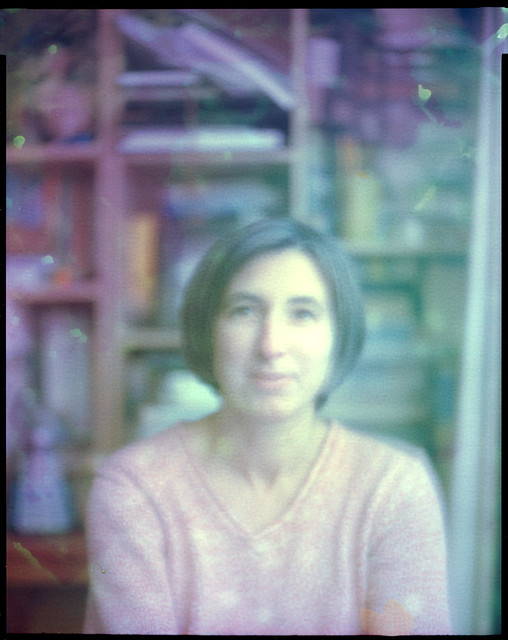

I've heard of this being done with colour filters and the 8x10 reversal prints looks amazing. The dynamic range is somewhat poor however. Would be very interested to see your results if you manage to figure this out.
Here is an example from flickr with some clues in the comments:
https://www.flickr.com/photos/wayne.../photolist-bT797z-bSK6BV-dLJCvi-dLHQgD-8hSnu7
Joe Kirschling 7y
no.. I don't have any mottling on mine.

I've tried this, the shot linked above is a good example of a problem I couldn't get around, namely the mottling, which is particularly bad in the shadows. Also the filtering, as above, takes a while to dial in and results in long exposure times. This was as far as I got before I gave up and went back to straight RA4 paper negs
Other people have had more success. I didn't really have the time to devote to it ... at the time :smile:

I saw the mottling as well with direct paper positives on rc paper. I think it's the unevenness of the coating which becomes apparent as you only effectively end up with using a fraction of the emulsion. I'm afraid it cannot really be eliminated.

I can't really properly see the mottling on the tiny screen that I'm using at the moment. But I can add that I've seen a lot of mottling when using fuji CA2. Also when using this paper to print negatives.
