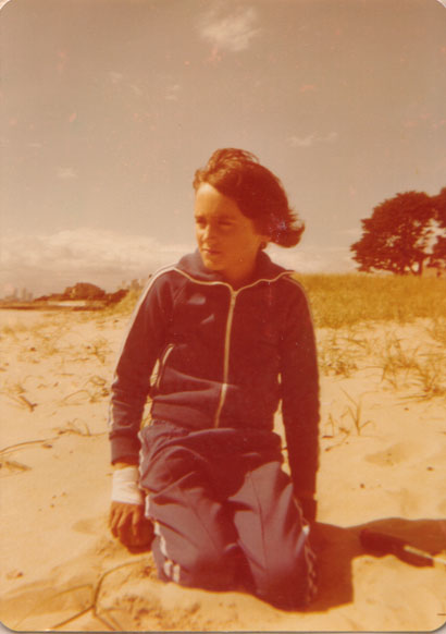

PE, I wonder if you would mind looking at the attached scan of a print, and let me know what is likely to have caused the fading?
This photo is around 28 years old, and was given to me by my mother for some drastic photoshop retouching to try and save the print. There are a whole bunch of photos that are doing this, but some others of the same age appear to have escaped the demon and are still as good as new.
This was printed on Koday paper by a lab.

That sure looks like Kodak paper from that era - HORRIBLE stuff! (at least by today's standards). Take a look at the Dead Link Removed web site and read the excellent article "The Permanence and Care of Color Photographs: Traditional and Digital Color Prints, Color Negatives, Slides, and Motion Pictures"...

Graham, the problem is probably cyan dye fade, probably dark keeping and humidity. It sometimes took place if there was too much iron in the wash water.
Sometimes, if the leuco dye was formed, you could reverse it by a ferricyanide bleach and then a wash in water for about 10 mins for each step (bleach then wash) at room temp. A stabilzer would then be needed to rebuffer the print. Use citric acid at pH 4.5 for this.
If you decide to try that just use a tiny corner of the print to insure you avoid damage to the entire print if it does not work.
Bob, yes, dye stability was bad back then compared to now, but consider the fact that dye stability had improved orders of magnitude from early prints of the 40s, and that the paper you talk about was about 2x better than the previous paper (T1910 vs T1970 papers). Also, consider that Wilhelm is, just like everyone, 'hyping' his 'product'.
Yes, he is a good watchdog, but he knew that the papers were improving. He also was aware of the differences between Fuji, Agfa, Konica and Kodak products and didn't show how bad the non-Kodak products of the time were. That was interesting to all of us working on EK dye stability at the time.
Kodak had made a quantum leap in dye stability at the time and presented a major paper on the subject at a conference. Dr. R. J. Tuite made the presentation for which I helped supply part of the data. Fuji, Konica and Agfa papers of the same era were very bad for dye stability but Wilhelm chose to ignore those products. It was not until the Fuji "Crystal" papers that dye stability took another step forward, and Kodak then swung the balance with their "Endura" papers. So, it is a generational thing related to synthetic organic chemistry improving dyestuffs.
In the final analysis, you can 'prove' just about anything you want by selecting the product and the conditions.
When oxygen diffusion is important in dye fade, how does a high intensity light source relate fade to the real world when diffusion then becomes less important. How do long term heat and humidity really compare to accelerated heat / humidity tests. The best we can do is extrapolate and that is all we did at EK and what Wilhelm does.
Omitting the really really bad stuff and showing bad stuff only tends to bias things in peoples mind set. Dye stability has been bad. At the time, Kodak products were the least bad by a long margin, but Wilhelm chose to not show that part of the story to its fullest extent. It therefore concentrated the entire situation on Kodak.
