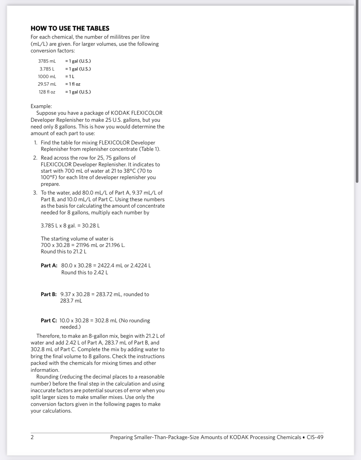

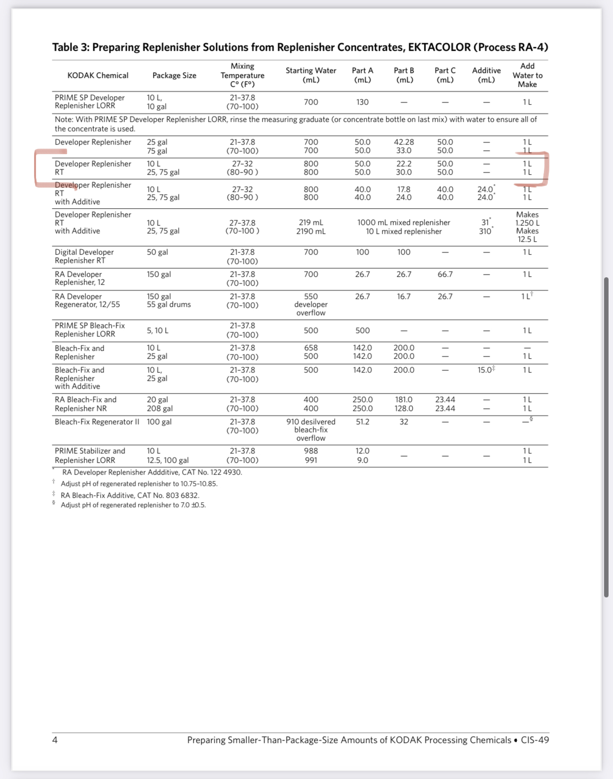

Matt, this is what I was referencing when going about my calculations.
EDIT: I have a whole sheet of paper with the working equation but I pretty much took the instructions to yield 1L. for the RA/RT Replenisher Developer & did the conversions & math to yield for 5 Gal.

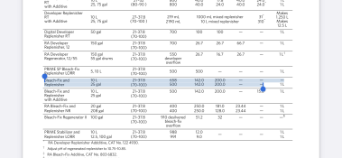

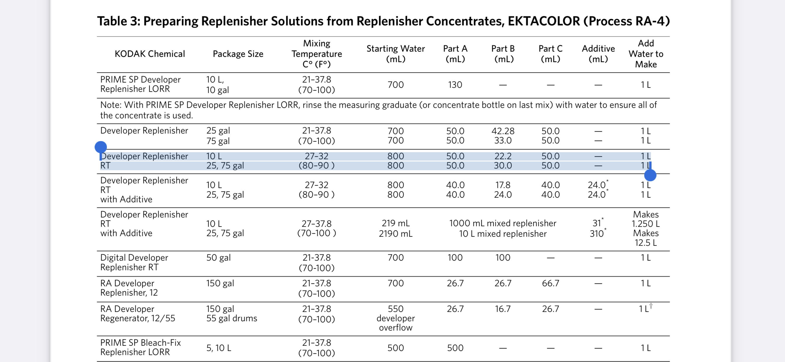

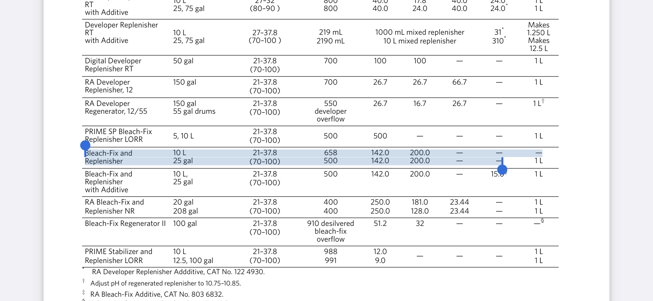

Makes sense! That being said, on the data sheet attached they have 2 different values for Part B between the 10L package & the 25/75 Gal. package. Why is that? I would just follow the directions for the 10L. values, correct?
Thanks,
-b

Last question!
Which directions do I follow when mixing my Developer/Replenisher & Bleach-Fix Replenisher solutions?
There’s (2) different instructions for mixing the 10L bottle compared to the 25/75 Gal. bottles (see attached)
I’m assuming I would follow the 25/75 Gal. mixing instructions?
(Bleach-Fix only offers 10 L. + 25 Gal. but there’s (2) options nonetheless)
Thanks,
-b

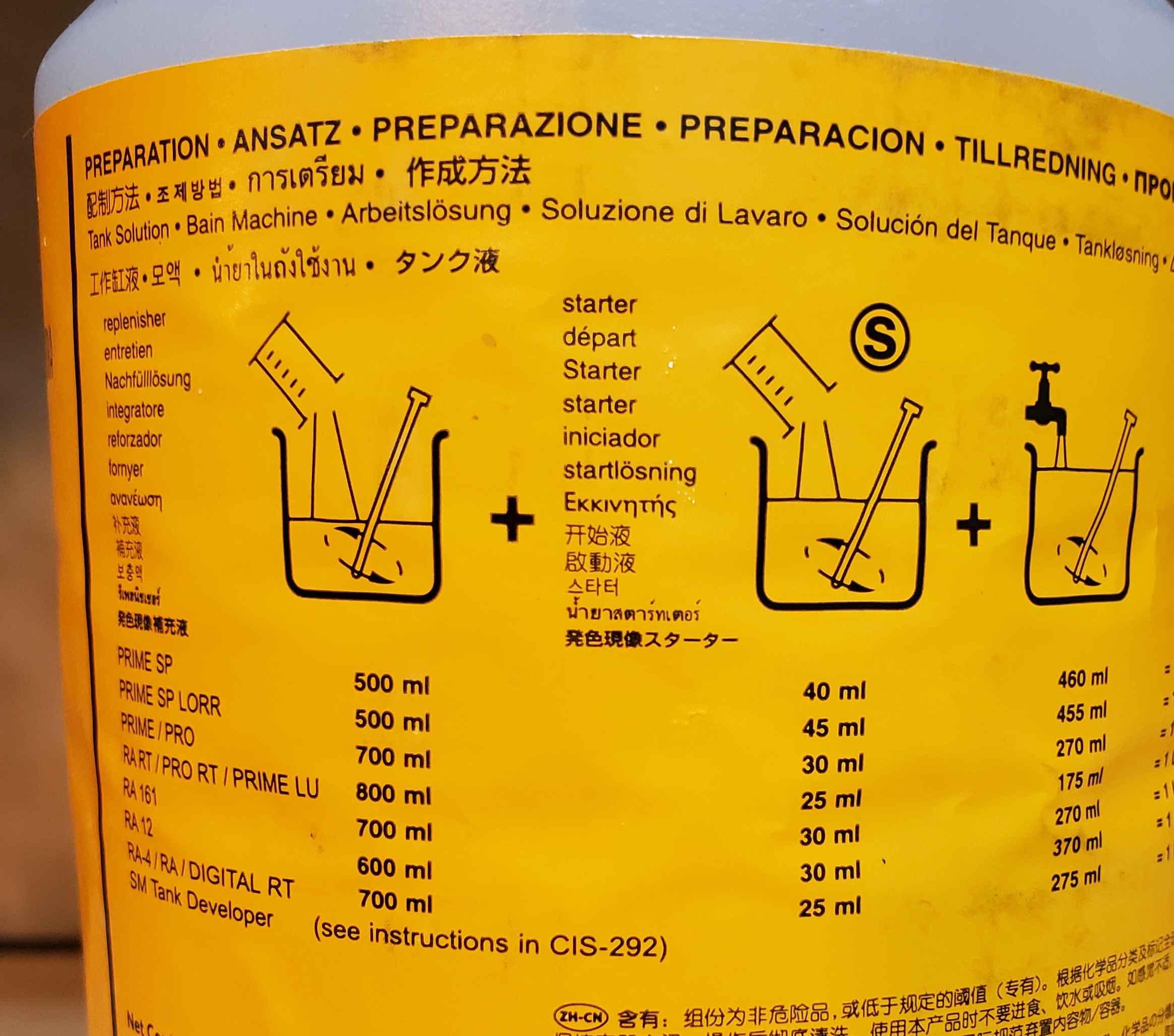

Looking at your original picture the mixing instructions are printed on the bottle of the blix. There should be instructions for the developer replenisher in the box as well.
The blix bottle says made in usa, which I think, means it's a bit older than the developer replenisher which shows made in China.
Dec 28, 2021
52
California
Yeah both Blix bottles have instructions for mixing to yield 1L. but the Developer Replenisher bottle doesn’t for some reason & neither does the box? It just has general information in a few languages & instructions to mix the entire contents without giving any info on measurements - only telling you to use “2 bottles of A B & C”…very strange
EDIT: but after doing some digging online I did find those instructions I attached in the previous post which breaks down how to yield 1L. for all of the Ektacolor/RA-4 types - but they have the (2) options to go off of - 10L. or 25/75 Gal. (i’m in between both of those options with my Developer Replenisher + my Bleach-Fix Replenisher package sizes).
