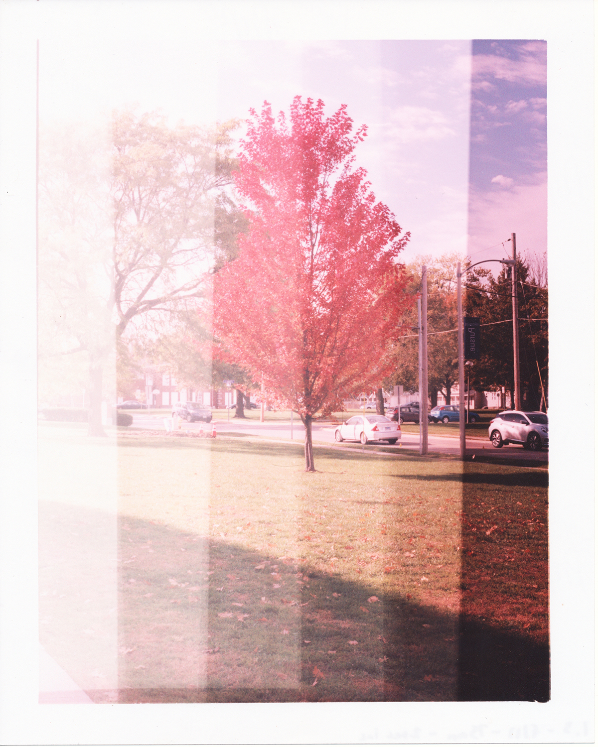

My first color printing session was a total success! I've been anxious and worrying for weeks but it turns out this process can be very forgiving.
I was originally going to process using a drum, but later I realize open trays might be faster if I could find a way to time in the dark. It turns out my parent had been using old darkroom trays that came with the house for potted plants for years. I gave the a through clean, mixed up a liter of chemistry (Kodak Ektacolor) and started. Mixing the chemistry is by far the most tedious part of this. I might mix up the full 10L of my stuff next time because I don't want to do all that measuring 9 more times.
I did not think my prints were going to turn out at all. I realized the GraLab darkroom timer I bought was glow-in-the-dark. After turning the lights out and pulling out paper I noticed a small light leak in my garage/darkroom ceiling. I was worried my colors and density would be off because I don't have a voltage stabilizer for my enlarger (thank you to anyone who helped me in that thread).
It turns out this process is very forgiving. The GraLab timer isn't nearly bright enough to fog paper, the hole the ceiling wasn't either, and my colors and density are consistent. After a few trys, building up muscle memory doing it in open trays was super easy. I would expose my paper, unplug my timer from the enlarge to use it without turning the enlarger on. I set the timer for 10 minutes mostly just to see the second hand go around. My times were not super accurate - most were around 2 minutes, some maybe a little longer.
This is my first sheet. I brought the exposed paper over to the trays but put it in stop first on accident, blix, and then realized I had ran out of trays.
My second sheet, I actually put it in developer this time! The exposure times are way too long - but you can actually see an image a 2s over on the right. I also had a crisp white border so I was incredibly revealed that my paper wasn't getting fogged. This had me super excited. It turns out I forgot to stop down my lens and I set my enlarger to LOW light instead of HIGH. This basically adds a 2-stop neutral density. I am using a enlarger for 4x5 and a 4x5 mixing chamber so I guess LOW is pretty essential for a 35mm negative.
This is my third attempt - this had me super happy. I had an image, it was sharp and had good density. Most of these were too bright at 2, 4, 6, 8, 10 seconds. (The last strip was accidently like 15 seconds). I decided to do another test strip at longer settings. My negative was also flipped so I fixed this.
Here is my fourth attempt. Not much to say here. I liked the 8s exposure (second from right) so I decided to do a full print there. I also added 6M to my starting 50Y, 50M. In my haste I had also been using the wrong negative. I have two of this scene taken back-to-back and one I prefer more. I switched the negatives out but didn't want to restart because the photos are essentially identical.
This is the first full print! My makeshift easel was misaligned and it still looked a little magenta, but I was close! I added 3M for a final filter pack of 0C, 50Y, 59M.
And here is the final print! If the colors look off it's because it's to replicate a physical print with a digital scan. Trust me everything looks great to my perfectionist eye in real life.
Again thank you to everyone of this site for your information and time. I am extremely excited to print more tonight!
Please feel free to ask questions or offer advice. The more information we put online about this amazing process the more people will want to do it and the more papers we might have to use.

Awesome! It’s been a while since I’ve done color prints... hoping to get back at it again

Yep, RA4 is easier than lore would have it. It's also a valuable lesson in being rigorous: having a trusted thermometer, working consistently and precisely, and learning how to make small corrections. I do it in drums on a Unicolor base, and it's pretty smooth sailing. Most of my energies are spent checking temps, adding hot or cold water to the water bath. But beyond that, it's all numbers: exposure, filter pack, rinse and repeat.
That said, to have pitch-perfect, super clean results takes a lot of energies. Fingerprints are rainbow-coloured, and they show quite visibly. Slight agitation variations, or light leaks can be deadly. But those are the same challenges that B&W possess, except that faults are more obvious in RA4.

RA-4 is simple and compared to black and white printing, cheap. I have been printing color for a few years now and it is one of my favorite ways to waste a day.
Consider buying paying in rolls and chopping it down to size. Kodak Endura is fantastic stuff.

Very nice print! RA-4 is a lot of fun. Super quick using trays and dead simple by running at room temperature. I find it very similar to black and white printing, except instead of controlling color contrast, you are controlling colour balance. It's very rewarding. As you correctly say, the "total darkness" is not such a rigid requirement. Of course you want to eliminate as much light as possible, but the phosphorescent paint on a gralab timer or an led across the room are unlikely to cause any problems.

RA4 printing is indeed easy - if everything goes well. If problems occur, they can be a b*tch to figure out, although it usually gives a lot of clues as to which parameters are critical and which ones not so much. For instance, with trays at room temperature, I find that neither temperature nor agitation are critical. Once you've determined an approach that works for you, it's pretty straightforward.
I'll take your word for it; the digital image looks way too magenta and yellow to me. But scans can be deceptive. Don't forget to "neutralize" your color vision by taking breaks when printing. It's deceptively easy to end up with significant color casts without noticing them.

Don't you think the most difficult thing is color balance? At least, it is for me.
I usually need three or four tests to get it (approx) right.
With a color analyzer and a gray surface, it is much easier. But printing "random" negatives is quite time consuming (though, very fun to do if you are in the mood).
I don't know about total darkness being essential. I always do RA-4 in absolute darkness. Once a tiny leak spoiled a print, and never experimented again. From there on, I even cover the timer (which has a very dim orange light, totally safe for B&W jobs). Maybe this is not even necessary :smile:

No, it's not harder than black & white, just different.
To avoid even slight color casts, check that the white items in the print are truly white.
Once you establish times and color balance for your enlarger, film, and chemicals you usually can make final prints, or at least come close on the first print, i.e., I haven't found it necessary to do test prints each time. This is the benefit of using the same film and developing your film and prints with a consistent method.

Before the printing process went digital, this is how small local labs handled most consumer processing (as far as I've understood): they had settings for each film they might expect to see, and just printed to those settings. If your film was underexposed, you'd get dark prints. Later, you'd still get dark prints, but they'd have a strong green tint -- I figures that was the automatic machines trying to "save" the image. These days, you'll get a grainy, noisy print with whatever image their scanner was able to pull out of the film...
