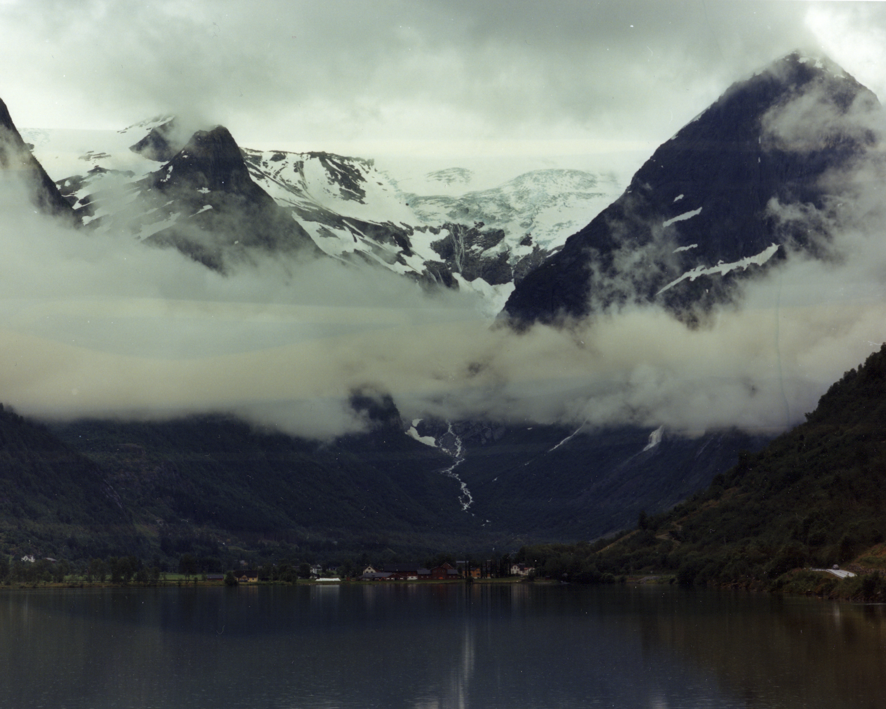

Today printing session has been a nightmare. I got constantly streaks in the prints and it is driving me crazy because I can't indentify where the problem is. The streaks are always horizontal lines with an apparent random distribution and size between prints, they have different color balance and lighter density.
Next image shows the print with the most severe defect, others are lighter than this or with least streaks.

That's really weird because the lines are neither parallel to the paper edge or each other. I also see a curved darker vertical line on the right side which may be completely unrelated

Yes, the vertical streak is another thing. It appears once in a while when I don't put a stop bath between developer and blix like in this print. I thought I would fix all with the stop bath but the horizontal lines remain even they were not so severe.

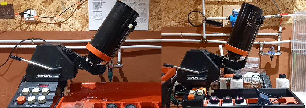

Compared with the previous Jobo machines I have used (CPE2, CPP3), CPP2 lift raises the tank less to drain the liquids from the tank. It is good because the movement is smoother and less abrupt but the drain is slower. Could be that more water from the presoak is left over the paper and it is causing the streaks. I will come back tomorrow to the lab and check it out.

Long story short. The lift not only drains more slowly than others I used (more than 30 seconds for 120 ml) but also some ammount of liquid of the last bath remains inside. Because I leave the lift up between prints, when I was putting the tank back for the next run I was introducing inside some water from the last rinse of the previous print. And THAT was causing the streaks during the tank warming in all prints... Besides the first one of the session (a "small" detail I didn't pay enough attention).
Solution: Put down the lift when each print is finished to drain the water inside (it drains through the chemical inlet!).
I also remove the tank and put down the lift after the stop bath rinse, to avoid introducing water into the Blix bath and dilute it.

I have had no problems with the tanks and drums draining quickly with the Jobo lift. It sound like your lift is not lifting high enough. The lift lever was broken on mine so I just lift the tank or drum has high as it will go and hold it up until completely drained, about 15 seconds at the longest for the drums.
That is absolutely what seems to happen, the tank drain position on the CPP-2 lift is about 10º lower than on the lift of my Jobo CPE-2. But it seems to be working ok, it just doesn't lift the tank high enough.
CPP2 on the left, CPE2 on the right
In some other time I will try to look or ask Jobo if it can lift higher.
