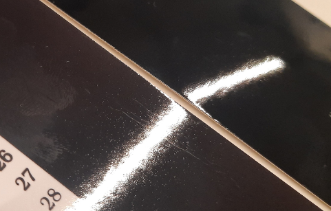

The paper has been stored the same and bought at the same time. I dont know though if the 8x10 paper and the 16x20 paper is from the same batch.
Do you get perfect consistency between prints and test strips with paper form the same pack?
This kit had some precipitate
That's odd. The concentrates themselves had a precipitate? In which bottles? What did it look like? RA4 concentrates should in general have no precipitates whatsoever.
Used RA4 developer esp. if it's re-used and replenished in a home setting usually throws down a black precipitate. If you're running a pro lab, then this is high alert & full alarm and it should never happen, but I find the developer generally works just fine (and consistently) for a long time that way. The Blix should be free of any precipitate whatsoever.
DREW WILEY
Jul 14, 2011
14,910
8x10 Format
I use two minute steps in drums to maintain consistency, since the fill/drain time is less a factor than with short 1 min or so steps. An intermediate stop bath is important too. My opinion of trays for RA4 dev has been posted before relative to respiratory issues. With trays you have more risk of temp shift than in drums, unless you have a thermo-regulated water jacket around them. And I've never had good luck with "room temp" RA4 developers.
There are various potential culprits when it comes to print to print inconsistency, even within typical colorheads themselves. When properly used and internally preheated with an initial plain water step, even large drums work just fine using one-shot chemistry. But not all drums are created equal.
AFTER you do pin down all the key variables and at least get consistency, then you can move on to the question of contrast control per se. The two main ways
to do that are via film choice to begin with (some color negs films have more contrast than others, some considerably less). Choice of specific RA4 paper gives you only a little bit of flexibility in that respect, unlike in black and white printing. The real silver bullet is unsharp masking, either contrast decrease or contrast increase style, but that has its own learning curve and necessary equipment needs. Flashing never appealed to me, but it might be worth trying for yourself.
Old paper is just looking for trouble. Buy fresh paper and chem.
pkr1979
Jun 25, 2019
577
Oslo
I do not know.
The precipitate was only in the developer concentrate - brownish of color.
Will do.
pkr1979
Jun 25, 2019
577
Oslo
Ok, that's not supposed to be there, but I don't think it explains the problems you've been having.
I am guessing the paper might be the cause. Its probably 6-7 years (if not more)... stored in so-so conditions. Why is the Adox paper high gloss? I like luster.
pkr1979
Jun 25, 2019
577
Oslo
But high gloss - isnt that gloss with some extra gloss? That is a lot of gloss.
