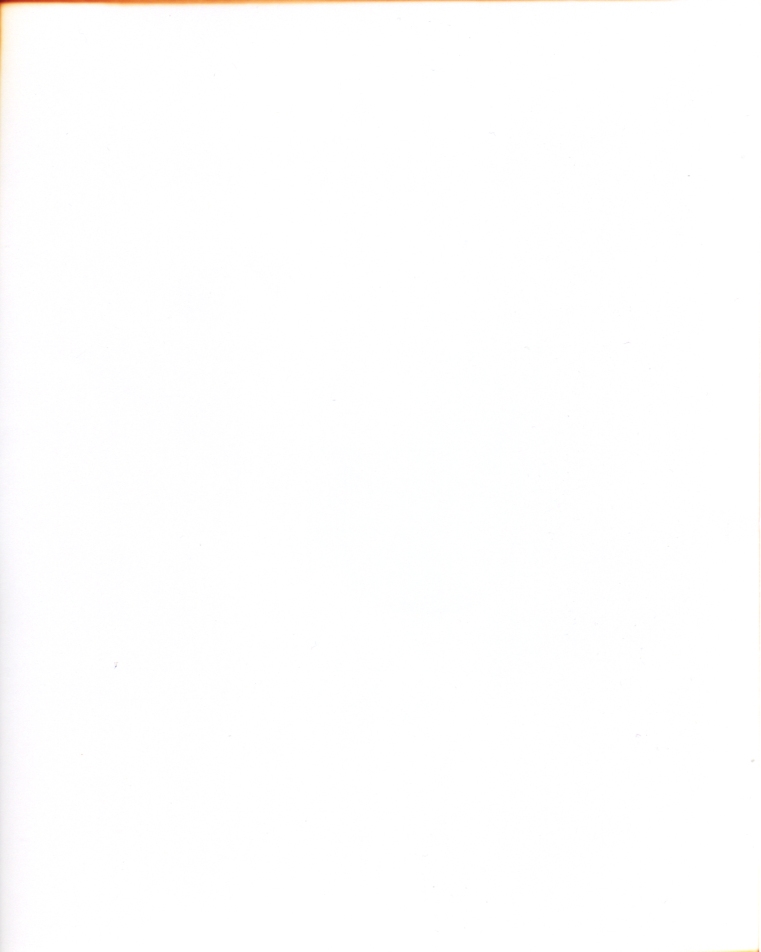

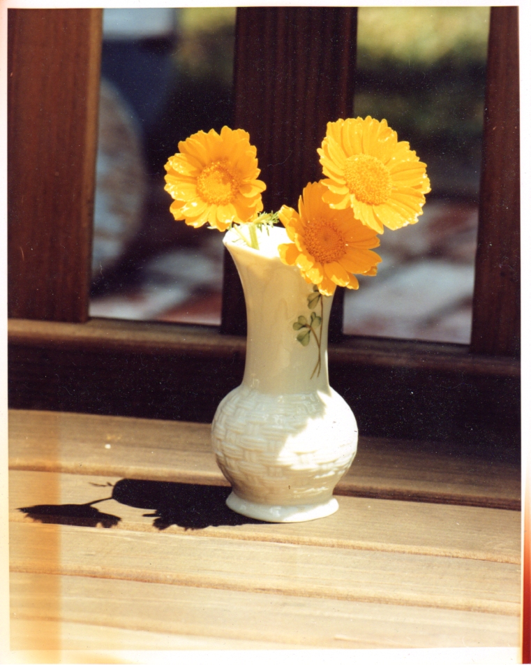

I'm a new photographer and I'm currently working on getting up to speed in the darkroom and with the camera. I'm having some issues with orange stripes on my RA-4 paper enlargements. (See image below).
The stripes to me look like light leaks. However, they're always parallel with the long edge of the paper and almost always in the margin on the paper (under the lip of the paper holder) (some times like image below the strip moves out into the paper -- lower left side)

3. The darkest orange stripes on the edge are under the metal edging of the Speed Easel not directly exposed.

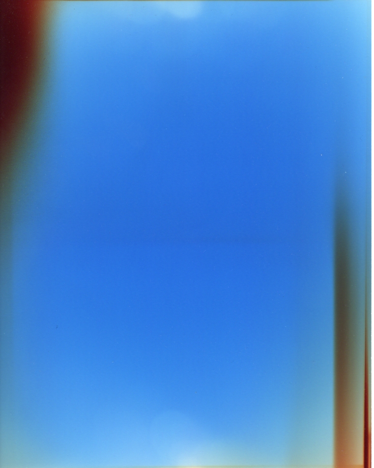

Test #1: Take a sheet of paper that's been sitting in my light safe for about a month (top sheet) and expose it to the safelight at about 4 inches for 45 seconds to induce safelight fog to see the color.
Result: Fog is a nice blue color, however large amount of orange-brown streaking is still seen (worse then normal)
Test #2: Take a sheet of paper out of the light safe (#4 down in the stack).. No safe light (except when the paper was cut). And develop again.
Color Staining on the edges where the sheets didn't perfectly align in the paper safe..
I think I can conclude that the red-orange tint / fog is light leaking into my paper safe. Safe light fog will show as a blue cast. Day light is showing as an orange-brown.
