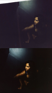

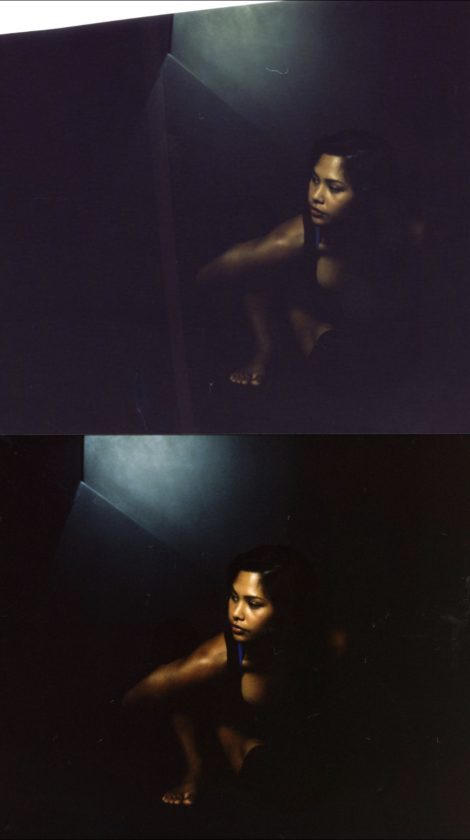

Thats right actually I’ve thought of that myself. For less contrasty image use CAII as it’s black are shite. Attached is a test of such an example. CAII top endura bottom. Portra 400. Also I purchased what is called Kodak PD paper (australia) which is for digital also. Talking to the supplier he said it is the same weight as endura but less silver content so less contrast. I’ve not used it yet as I’m in between houses and not printing atm

@Joakes thanks for posting that. It perfectly matches my observations with CAII. The old CA did produce very good blacks, CAII is just an abomination IMO.
Yeah when I realised this I actually threw out the whole box just so I could store my endura cut sheets. Apparently DPII is the Fuji paper you want to use.
I'm quite happy with crystal archive supreme and supreme HD (I see no difference between the two). Haven't tried DPII, but don't see a good reason to either since Supreme works as it should and is much sturdier than CAII (although not as sturdy as Endura).

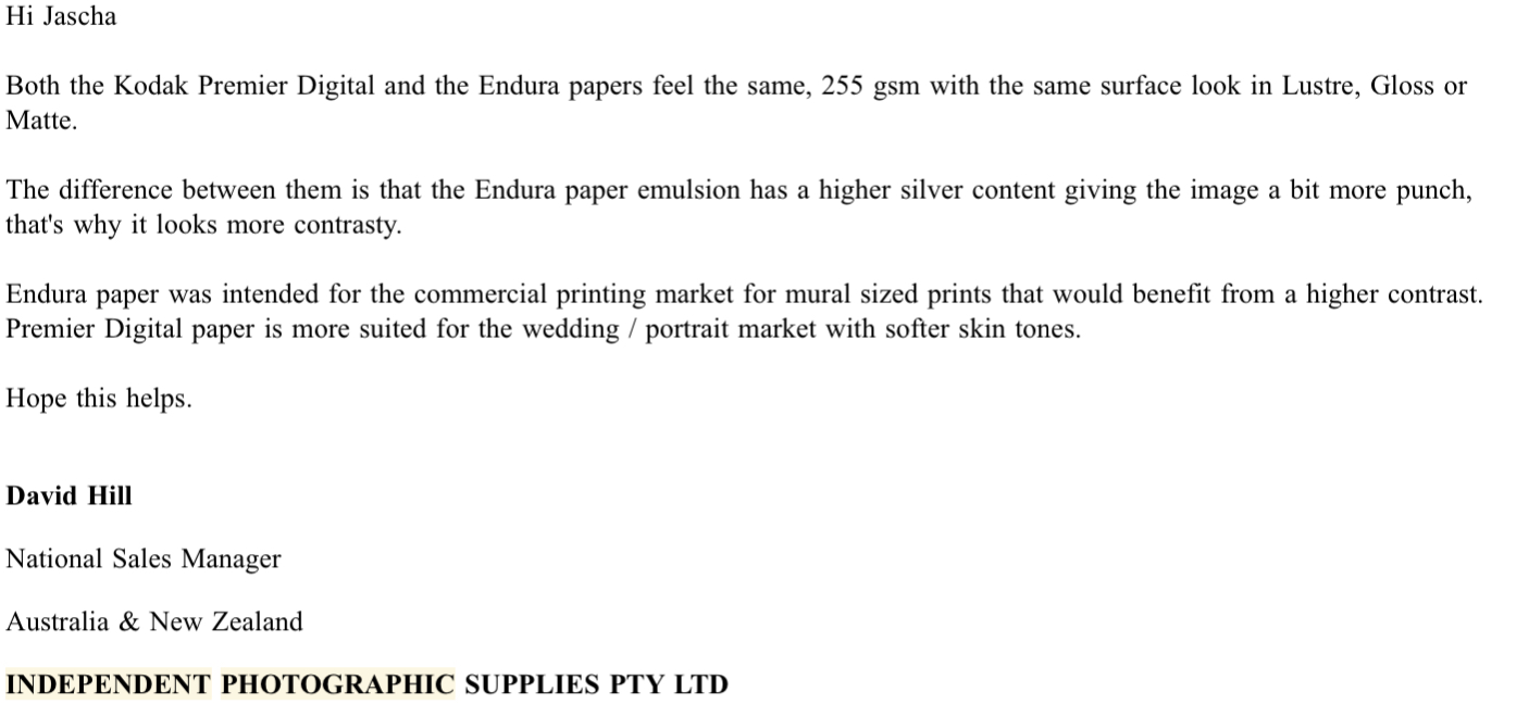

How does supreme compare to endura in terms of contrast?
It doesn't. That is to say, its contrast and color balance are similar to the other Crystal Archive papers. It essentially gives the same colors as CAII but with good blacks, so technically contrast is a little higher.
