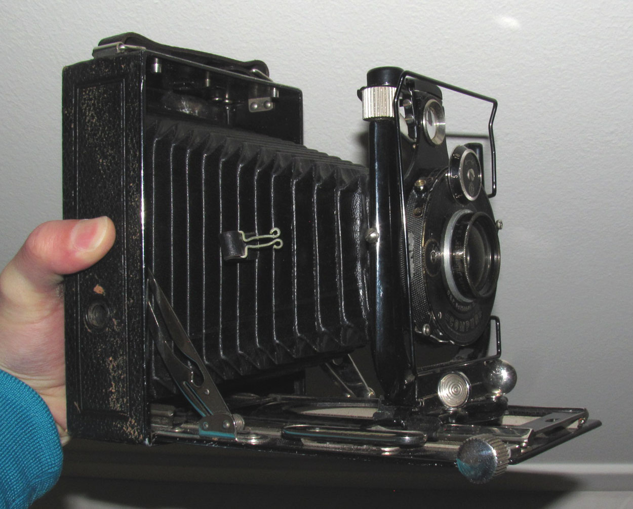

I bought a Voigtländer Avus 9x12 that had bad lightseals and a non-working Compur, replaced the lightseals with velvet ribbon and cut washers from a DVD case so I could mount the Iricentor. The yellowed balsam is even, so it should work as a very light yellow filter. I was wrong in the above post. The Iricentor is a true Dagor design. The gentleman who owns the oldlens.com site sent me the RÜO Optik catalog page for the Iricentor.
The outer diameter of the lens is 32,3 mm. The Voigtländer lens hood fits, but not the B+W push-on filters.
