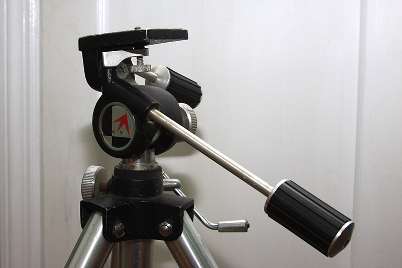

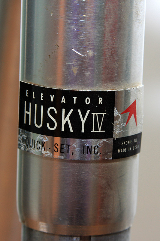

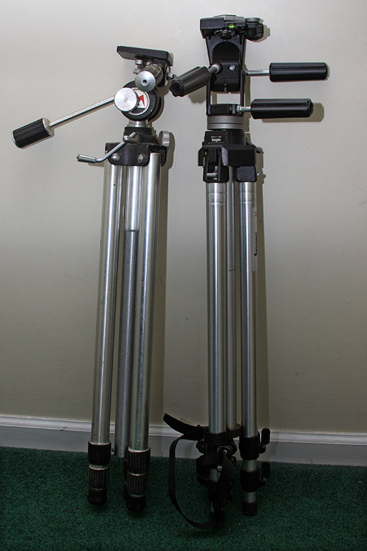

I just received a Speed Graphic I had won at auction. As a bonus, it came with a tripod that when I put it together seemed to rival my Bogen 3o21 in size/weight. It's got a label on it that says Quickset Inc, Elevator Husky IV. Can anyone tell me anything about it? It seems more than solid enough to support a 4x5 Speed or GraphicView or pretty much anything else I could throw at it.

A little more information might be useful. The Quickset, Incorporated "Elevator Husky IV" does sound familiar to me. I think that was the one I had back in the 1960's-70's. I thought it was a "Hi-Boy IV." I do have a replacement one now, but it does not have the label on the center column.

Your comparison with a Bogen 3021 is surprising. I think my Husky is bigger than my Bogen 3021, especially in comparison to my 3021S. Clearly it is not bigger than my Bogen 3026.

Thanks for the comparison. Sounds like yours is similar but not identical. This one weighs 7lbs (3021/3047 weighs just over 9). Leg segments are around 21 inches. With legs fully extended the head is around 5 feet and with center column fully cranked out it's a bit over 6. I never pull the column all the way out on the 3021 but I think they are comparable in height. They certainly look similar in size and construction side by side with the main difference being in the head. The Quickset has a 1/4 (as does the Bogen) - matches both my Speed Graphics and Graphic View II as well as Canon EOS gear so for right now I don't need to worry about that. I'll need to take a better look at the constrcution of this one and see hoe tight it's holding up. I've done well with the Bogen for my 4x5 gear (and, judging from the arc worn into the cork on the Quickset it's been used to hold a GV as well). My biggest beef with the Bogen is that it's too big and heavy to lug around. On a recent trip out west I left it home and used an old Velbon that really isn't up to the task of holding anything more than 3-4 lbs. Perhaps I'll be more willing to carry the Quickset. Is Quickset still around by the way? I've never heard of them before.

Thank you for the photographs. Your Quickset Elevator Husky IV does indeed look very much like mine.
One point of difference is the device that locks the 1/4-20 screw and camera to the top plate. Yours seems to be a locking lever. Mine is a large black plastic "wheel," and the original one also had that "wheel." Yours may be a later production unit.
