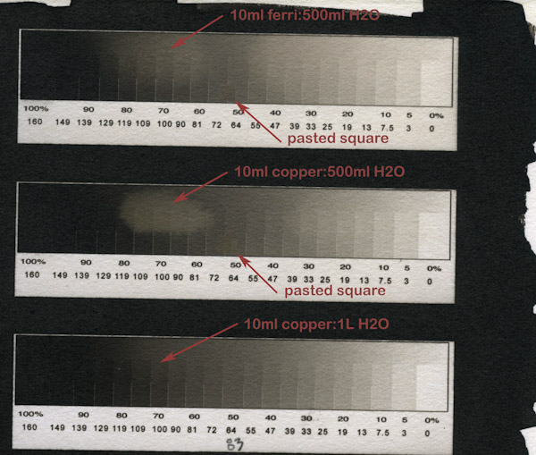

So attached are a couple of test strips that I did some selective toning to. One is a kallitype processed with Roschelle salts and no toning. The other is developed in Sodium Citrate and toned in pd. While I thought the un-toned would work best, that was not the case for me. The un-toned print changed color. I would assume that I am not toning to completion with the pd, which is why I am getting bleaching. But it held the original color much better.
The bleach needs to be very very dilute or it just dissolves away the image in seconds.
And the pasted square is where I copied a small square from the beached area and pasted to an unbleached lighter shade to see if there was color shift.

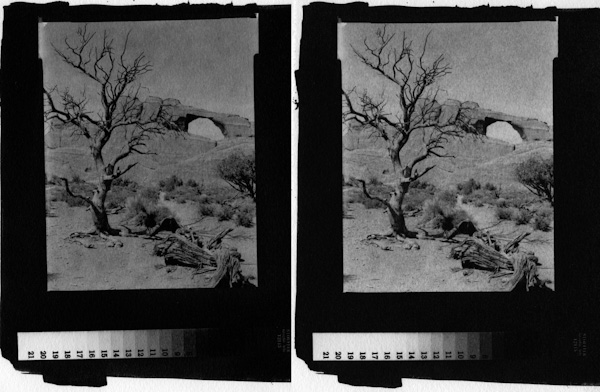

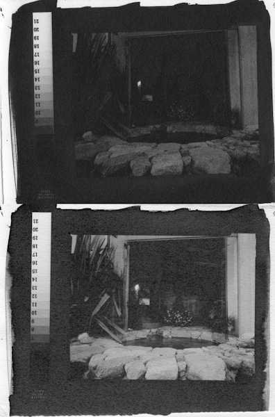

These are a couple of over-exposed prints that I bleached the entire image. They are both un-toned and developed in Roschelle salts. The tree image was bleached in 10ml of stock ferri bleach diluted to 1liter and bleach for 10 minutes. The other is bleached in 10ml 10% copper sulfate: 10ml 10% bromide and diluted to 1 liter for 5 minutes. Unfortunately on the original scans prior to bleaching I did not scan in color. The pool print was way way overexposed and came out very grainy with a ochre color that is not pleasant.
Neither of these prints were very good to begin with, both kinda grainy and not very smooth tones. But good for sacrificing for a test.
