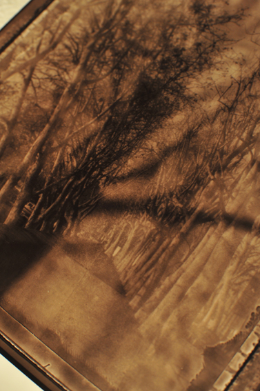

Help please,
I have a print made last night that is a little too dense. I did tone it in Selenium.
If I do some selective Ferri in the highlights will it be effective despite of the previous toning ?
It wasn't tone to completion.
Thanks,
G.

If you try it using a dilute ferricyanide/bromide bleach if it doesn't look good you can always re-develop it provided of course you haven't refixed it. But the chances are the selenium ton will look odd.

I have 2 solutions.
- Selective as above.
- Quick bath of the whole print in a very dilute ferry...
Crazy ? or not ?

Guillaume, you'll need to dilute a normal bleach bath used for sepia toning with about 4 times as much water as usual, maybe more. So if it should be 1:10 try 1:40, or even 1:60, try it on a scrap print first.

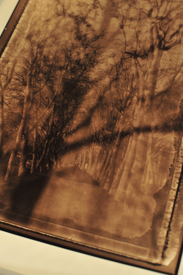

GOOD RESULTS !!!
Ok,
Bleach diluted 1+200
Quick rinse
Fix
Wash
There is definitely a color shift, more toward chocolate. This is very interesting . So it works !
Thank you.
Guillaume

That print would have gone to the trash. Too dark and no punch.
The chocolate shift doesn't go with my series. I will have to redo it anyway.
But this is good to know that session works, selenium then bleach.
