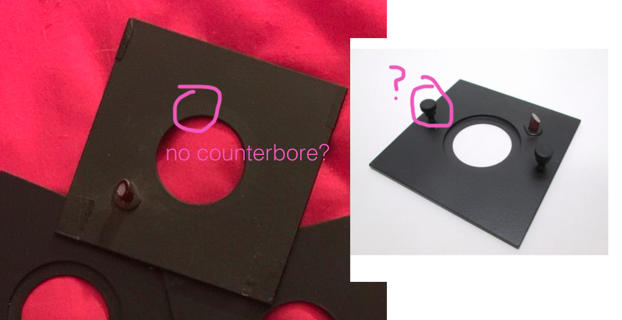

2. Eventually I'd like to make enlargements from 120 negatives. I know I have to get a 6x6 negative carrier and a 75-80mm enlarger lens. From a cursory Google search for the lensboard it seems like I have to get a different lensboard for different enlarger lens and the lensboard offered is for fitting a 75-80mm lens, not the 50mm... I need a #8021 for the 50mm lens. I'm further confused because looking for a #8021 lensboard gives me two different looking lensboards... Which one do I need for the 23CII Dichro? Will either work?

I have a pdf of the enlarger manual, which indicates that an 8023 board is for the longer (53mm to 90mm) lenses, and an 8021 board is for a 50mm lens.

Either can be used with condensers or with the provided diffusion cone. Make sure you have whichever you want (or better, both). Depending on your lens, you might not need the counterbored lensboard.
