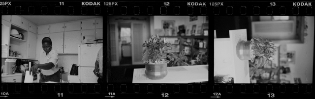

I just processed my first negatives last night. Did 2 rolls of 35mm Plus-X 125 in HC-110 for 5.5 minutes at 72 degrees. 1 roll was shot with a Nikkormat EL and the other in a Canonet QL17 GIII. Now about 2/3rds of the shots look a little overexposed. How can I tell if this is from the cameras during initial exposure or if I over developed the negatives? These were mostly shot in fairly bright midday light and shot according to the meters on the cameras. I've attached a couple frames that I adjusted to a b&w positive. If it would help, let me know if I should post a straight negative scan. Thanks in advance for any help.

From the images you posted, they look quite within acceptable range to me. One way to tell if they are in fact over exposed/developed is to contact print a set of negatives you know are "good", and then contact print these using the same exposure and development settings as the "good" set. That will show you how far off you are, and help you determine where the problem, if any, lies. If the problem is over-exposure, not only will the contact prints be too bright, but they will be too bright across the range (great detail in the shadows, but weak blacks). If they are overdeveloped, your highlights will be blown out and detailless, but you will still have good blacks in your shadows.
IF there is indeed a problem, I'd be first inclined to blame the meters, given the age of both cameras. It is quite possible for their meters to drift over time and become less sensitive, thereby encouraging over-exposure. Black-and-white film is very tolerant of overexposure, so this is not something to be too worried about unless you start getting really dense dark negatives that take a very long time to print.

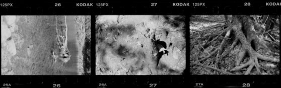

Thanks TheFlyingCamera :smile: Unfortunately, I have no other negs for comparison and I don't have the ability to do prints YET. Right now I only have supplies for processing negatives. After looking more through the roll, I am inclined to say it is the metering. HEre's a couple shots from that same roll taken indoors and they seem fine. I'm assuming the harsh mid day sunlight was throwing the meter off or maybe I was doing something wrong? Think I might have to start looking for a handheld meter.

In my opinion your film looks ok.
When you overdevelope you get a film with very high contrast, so the bright parts are too dense and the shadow still closed, making a contact print you will spot it immediatly.
On the opposite a overexposed film will be with similar highligths, but the shadows will be too clear and open, with a lot of details.
Don't forget the basic rule: expose for the shadows and develop for the highlights, so don't be worried if your cameras do a slight overexposure, just fix the development to avoid too dense highlights and be happy.

It's tough to guess from your scans because the scanner software will auto-adjust the exposure toward "right" exposure. To me, the indoor shots look a bit flat and gray, and the outdoor shots look good. That would still point toward a metering problem, which would make more sense - that the dimmer the light, the less accurate the meter gets. It would also help you if you could get to see some good negatives made by an experienced photographer. Every medium of output, be it scanner/printer, silver-gelatin paper, platinum/palladium, cyanotype, or something else requires a negative crafted to suit the medium. A negative that produces a good scan will look different than a negative that produces a good silver-gelatin enlargement. Since you don't have ready access to darkroom materials, another good way to judge your meter accuracy is to take film processing out of the equation. Go shoot some slide film. If your meter is overexposing, it will give you washed-out slides. If it is underexposing, you'll get dark dense slides. Since slide processing is done to a standard methodology, this will eliminate operator error (yours) in processing. If your slides come back well exposed, then you'll know it was your error in processing. The best way to determine this is to shoot some scenes on the roll that have some bright highlights with detail, like clouds. Shoot some others that are more even in brightness range - perhaps a well lit interior with natural north lighting. This is soft and diffuse, and will not create brilliant highlights or profound shadows to fool the meter.

I REALLY wouldn't worry. As far as one can tell from scan/monitor, they're OK -- but the only true test is whether they print OK on grade 2-3 paper, with adequate shadow detail, and until you can do that, all any of us can say is that they don't look at all bad.

Its really hard to tell from a scan, because the scanner can correct a great deal for overexposure. Keeping that in mind, whatever exposure you used, it was well within range of the film, so I would tend to echo Rogers sentiment in that you are on the right track.
Getting perfect exposures on every frame is difficult, especially when you are first starting out, and learning how your meter behaves. I would suggest getting a hand held spot meter and using it in conjunction with your cameras meter, to see how values within a composition play out on the film. Try it with slide film as well, so you can appreciate the difference in latitude.
Another suggestion is to run a roll on the same subject and composition with unchanging light, and bracket exposures in 1/2 or 1/3 stop increments for several stops in each direction from the metered exposure. This will help you see how your negative looks as it transitions from under, to over exposure.
There is no "really correct" exposure, except the one that suits a particular preference. I prefer to work with "thick" or "bulletproof" negatives (what someone else might call overexposed), because it suits my processes and printing style. Photographers often develop personal film speeds for particular emulsions, that differ from the manufactures box speed, to suit different processing and printing methods.
Some photographers feel a slight overexposure from "correct" is better, as you can't print what's not there. When in doubt, bracket.
BTW, after 25 years of shooting, I still blow an exposure on occasion.
