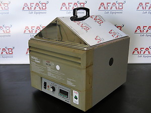

Does anyone have tips on keeping the water temp at 105F? Meaning, does it seem to work by filling a plastic tub at the correct temp and just keep topping it off to maintain temp or is a heater required? I looked around for a submersible heater and haven't found anything that would go to 105F.
Thanks,
Larry
kmallick
Apr 1, 2011
151
Denver, Colo
I have seen people use plastic tub. But since I do my E-6 at home regularly, I broke down and invested in a thermostat controlled water bath for scientific laboratory use like this one. I got it el cheapo on eBay.
largeformat65
Jun 22, 2012
27
Thanks for the tip! I was able to find a heat controlled water bath as well and got it ordered. This should work out great.
Thanks!
