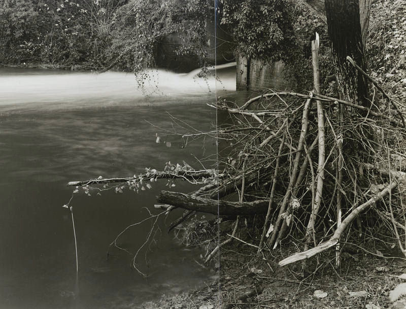

Selenium toning the negative will work with negatives developed in Pyrocat hD. Another option is to tine the print with Ilford IT-8 Toner, but this gives quite a colour shift towards Olive Black, it does intensify the print as well, essentially the Bleach is similar to a Chromium Intensifier and the redeveloper a simple Pyrocatechin formula. In practice I use Pyrocat HD at 1 +1 to 25 as the redeveloper and get the same results.
Print - Forte Polywarmtone FB, Developed in ID-78, right half toned in IT-8
