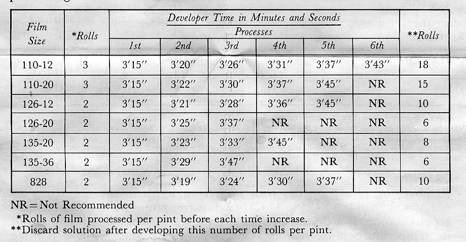

4. Depends on your development hardware, whether it is a tube, drum, etc. For 4x5 I use the smallest Paterson tank, which is around 750ml. So for me that is the answer. The attachment is from Photo Engineer and shows capacities. You can calculate minimum required volumes from this, and make a decision based on your equipment.
