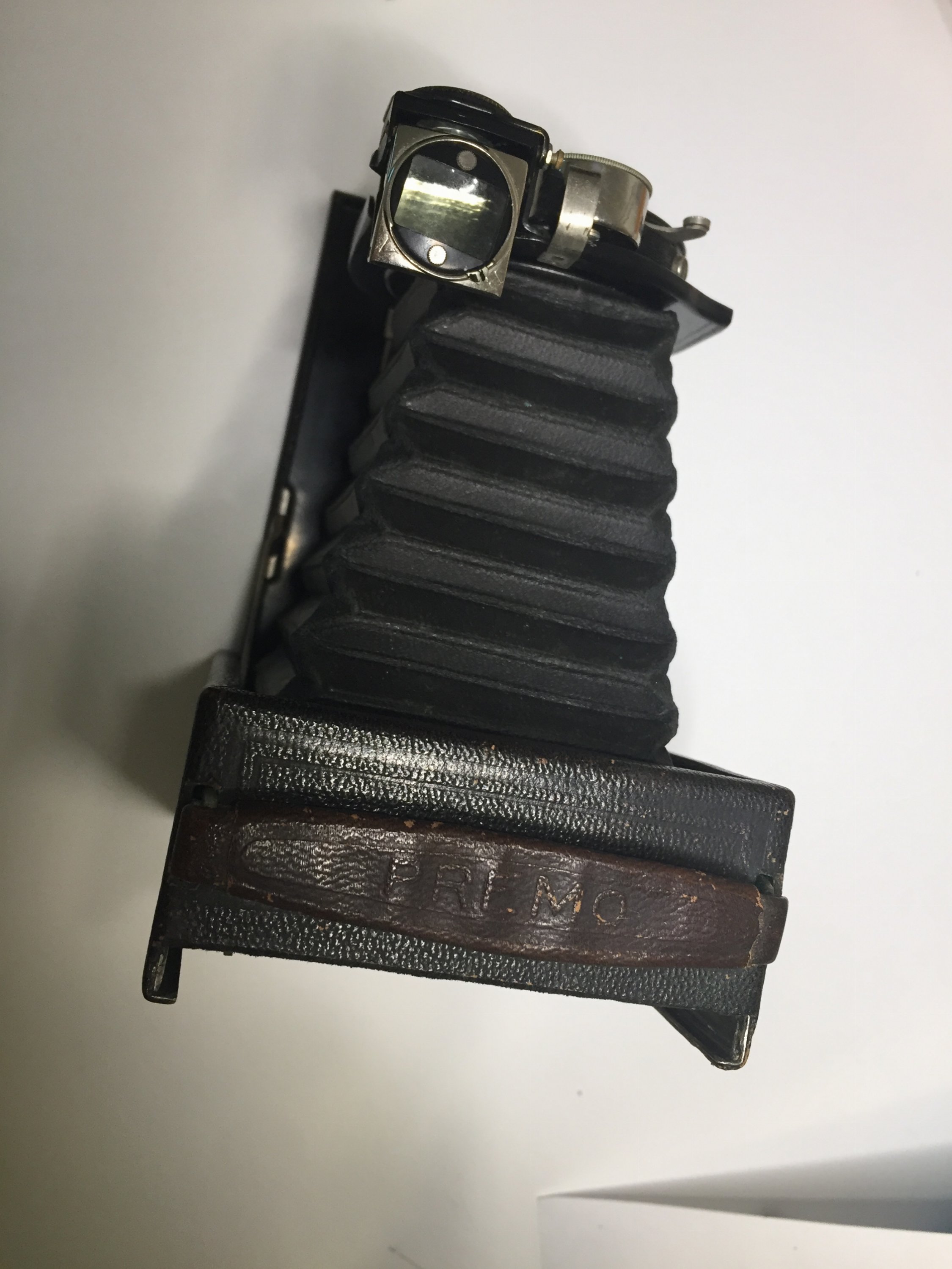

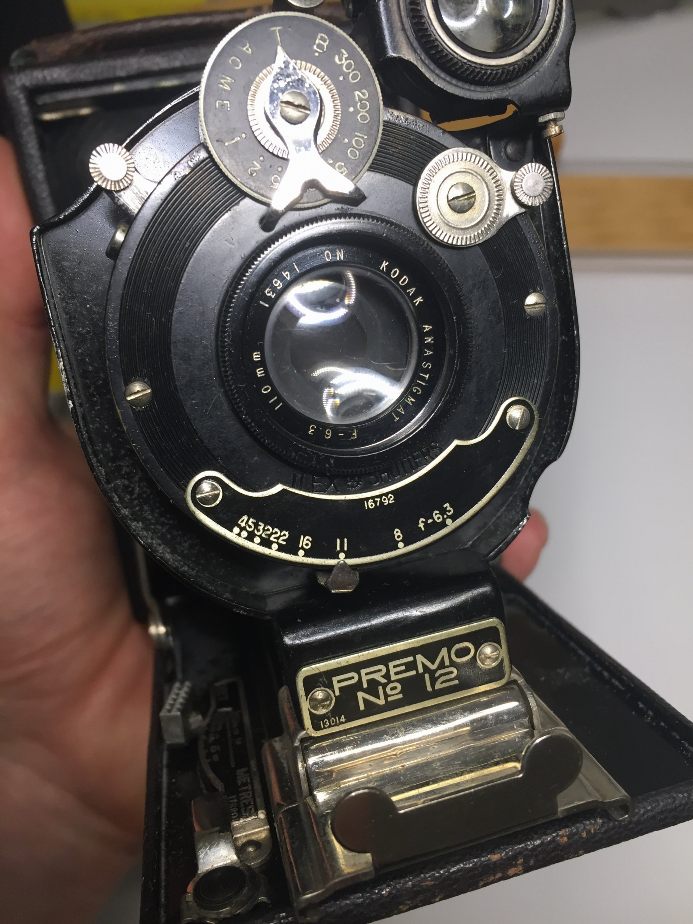

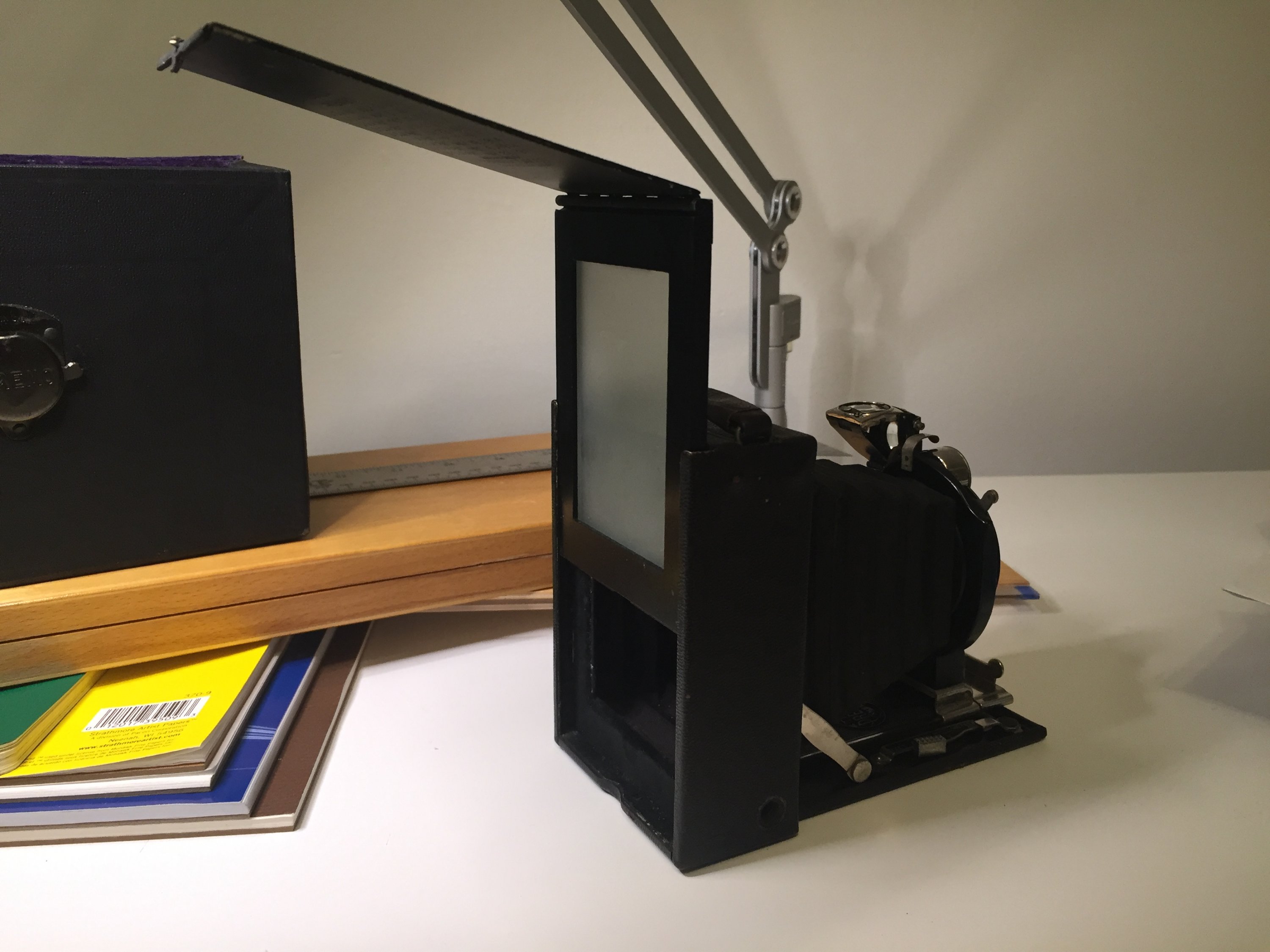

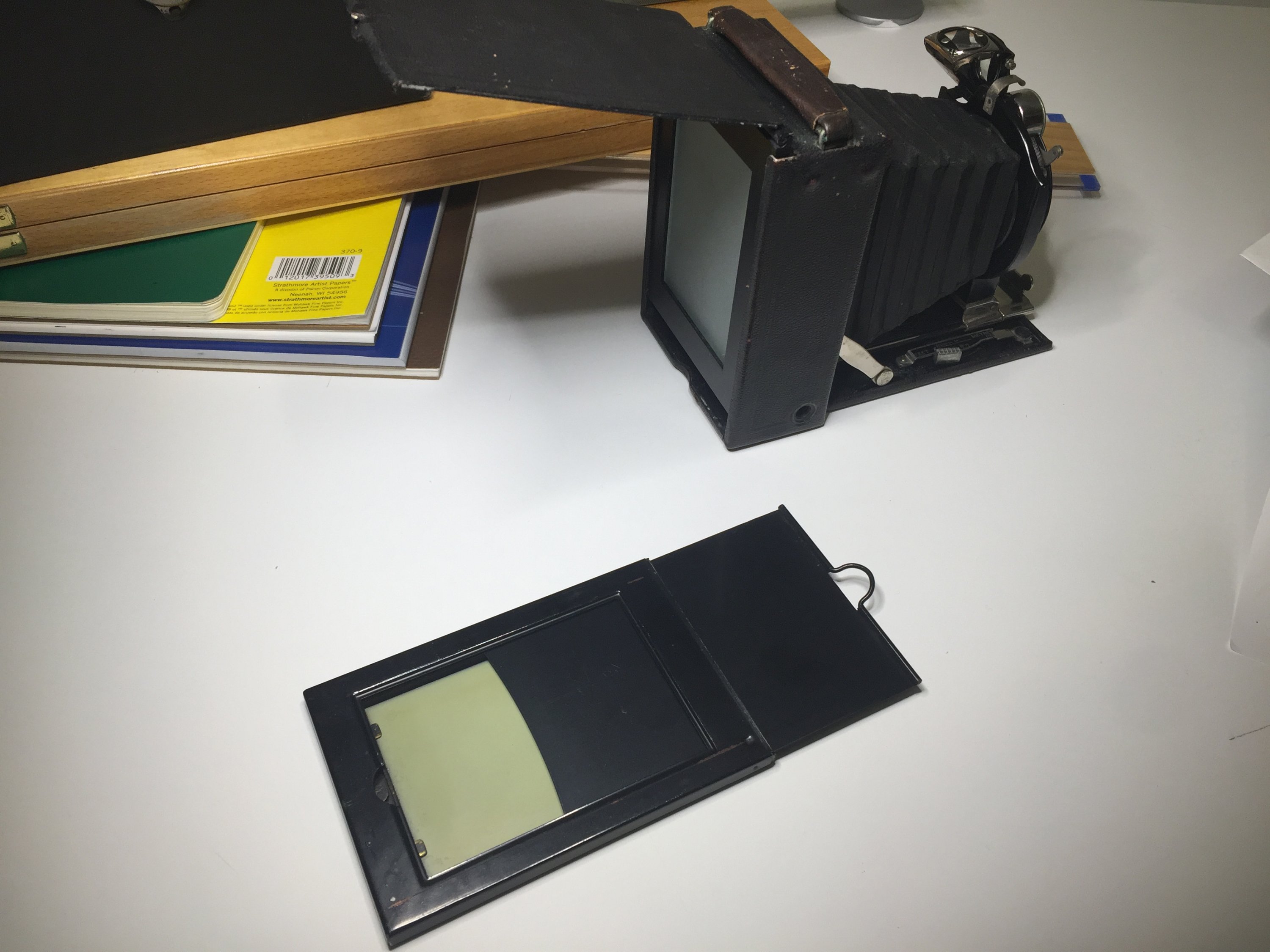

Everyone, thanks for your attention, I do appreciate it. Mr. Shutterfinger - I am indeed on planet Earth, if only for a while, and I reside in Philadelphia. Attached are a few pictures of the camera showing some detail. Also, thanks for the links to the period catalogs, which are wonderful!

Thanks for the images. Ilex Acme shutter! Who'd a thunk it? And the GG and film holders slide in. My memory is clearly failing. Adapting a modern roll holder might be possible after all.
I'm in Cherry Hill, also on earth. We might be able to get together with y'r Premo and one of my modern Graflex roll holders for a trial fit. I'm not hopeful but the question hasn't been asked yet.

A roll film holder will need to be fitted to a film pack adapter frame or have a frame custom made that slides into the camera. Film pack adapters in the catalog have a single light trap ridge so the more modern ones with two light trap ridges may have to be modified.

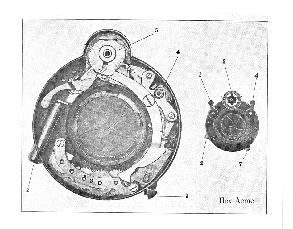

I have never seen an Acme dial set before, internally its likely similar to this one
Tested, a 2x3 RFH base matches the base of a film pack adapter. Depending on how deeply the ground glass is recessed into its frame will determine how thick of a shim will be needed to position a RFH film plane at the same position as the front surface of the ground glass. There is a chance the wind knob will hit the holder edge of the camera and a lever wind Graphic RFH will be worse.
