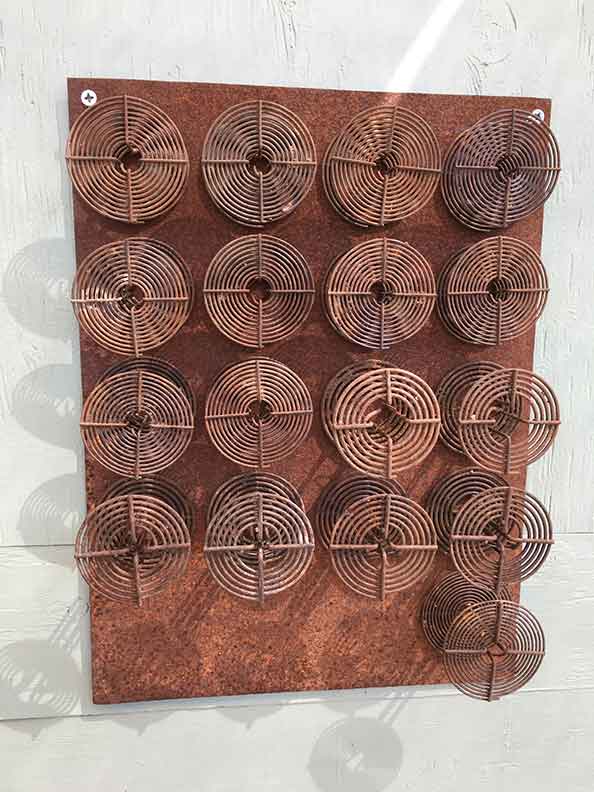

Nikor was the best back in the day, heavier steel and perfect alignment. I couldn't just toss it after the fire so it's mounted on cortin steel on the wall of the new darkroom.
