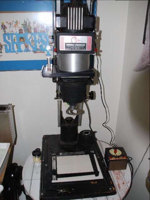

Attached are pictures of my new (to me) Omega D2, which I believe is a D2V, despite not saying it specefically on the side. Right now, it's set up for a cold-light head, of which i'm unsure of the origin. I have a few questions about this enlarger.
Why does my cold light head have two power cords? It operates fine using only one, the two pronged one, yet it has both a two prong and three prong cord. I've only tried the two pronged one, since that's the outlet in my bathr... cough... darkroom, so i don't know if the second does anything.
Secondly, can I print formats other than 35mm with this thing? Where do the negative carriers go, directly below the cold light head/in between it and the massive 4x5 carrier?

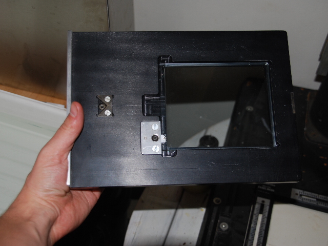

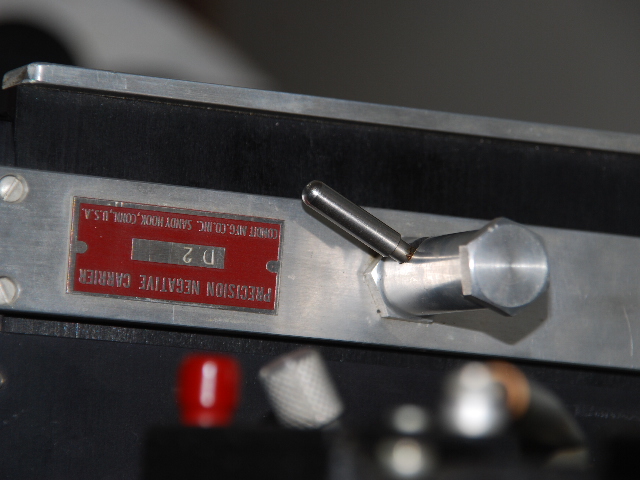

Thirdly, has anyone ever seen a "Precision negative carrier" before? I'm impressed, it's a pretty solid piece of metal.

There are also these rails on the base of my enlarger... What are these for?

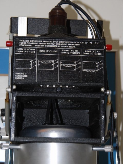

You have a DV condenser head, but the enlarger appears to be a DII—not a D2.
The DII has a “push-pull” carriage to raise and lower the carriage along the column.
The D2 has a geared elevation crank to adjust the carriage height.

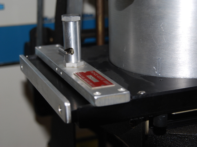

The DII has a unique base column casting with a single large locking knob to secure the column to the base casting as can be seen in photo #2.

The negative carrier is Condite Manufacturing Precision Negative Carrier for the DII and D2. This is an aftermarket product having nothing to do with the enlarger maker Simmon Brothers Omega.
The rails on the baseboard are also aftermarket. They’re likely to locate a dedicated easel, possibly an easel for handling continuous roll paper.
