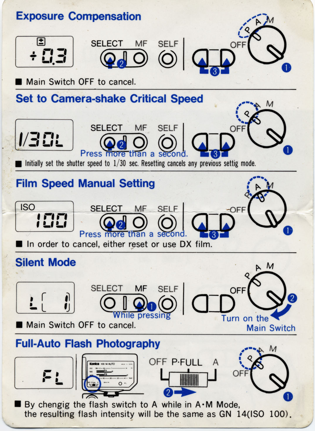

Next...I guess you have to set exposure compensation each time you turn on the camera? Each time I turn it on, the top screen turns to 0.0.

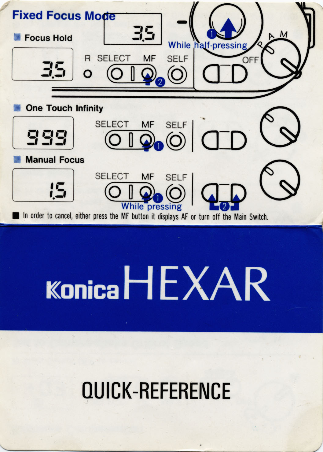

Here are a couple of jpegs that I found of the quick guide. I'll post in case they're of use to others.
Interesting, I did not know about that MF-feature.
But how to operate the Focus-Hold (graphic #1) AND holding the camera properly ??

I guess just centre on the specific focal point and then re-adjust with the shutter halfway pressed.
No, you have to press two buttons. Both on the right side. Needs two hands...
That's what my question above is about.

So, when would you use that "Focus Hold" ?
And as you got that camera in hand meanwhile, how do achieve this very procedure?
