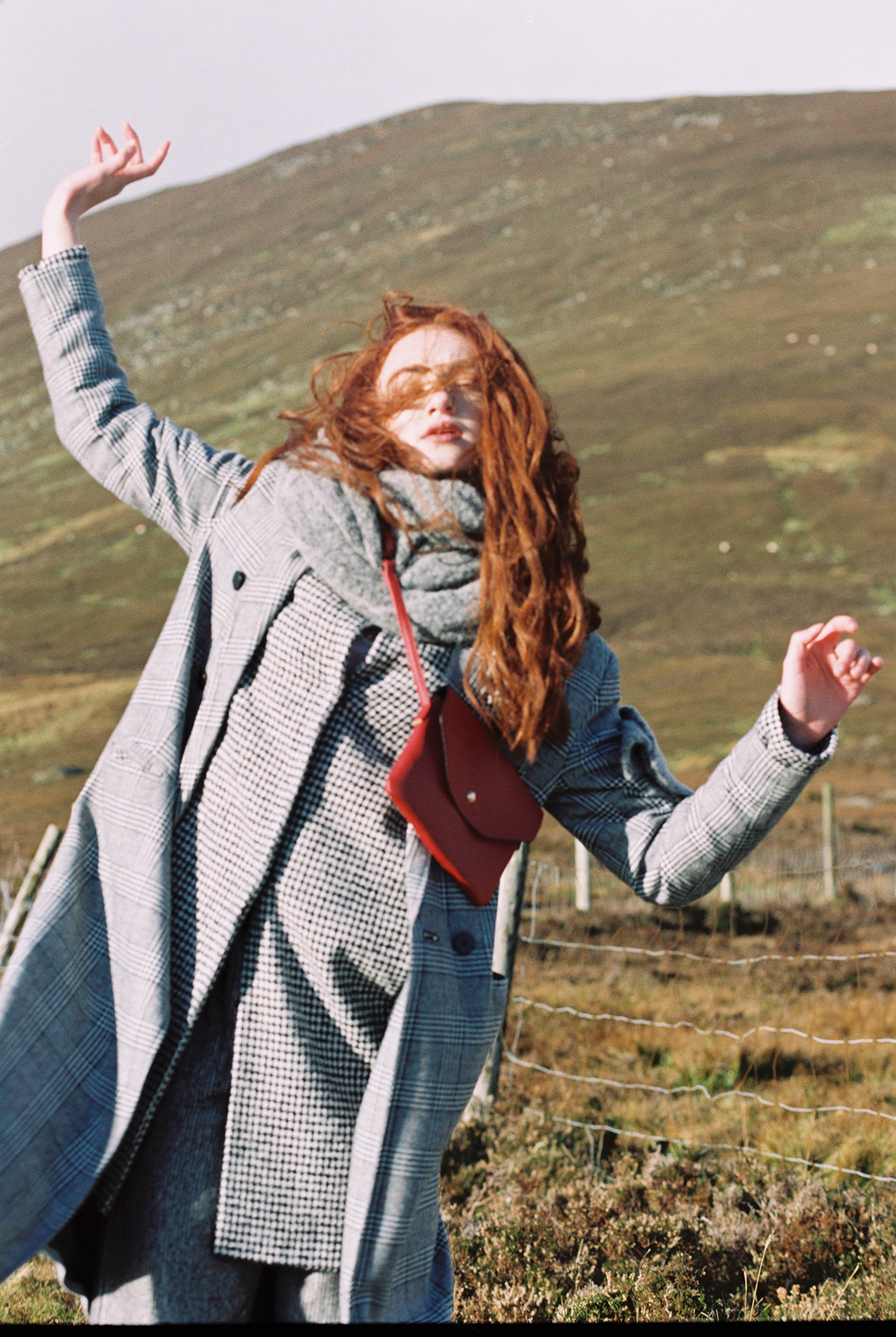

Hi everyone,
I've got a few questions, I'm hoping someone can set me straight.
I bought a Canon EOS 1000f body so I could use my 85mm f1.8. I was out shooting and I wanted to give the AF a try, but I remember the camera focusing just behind my subject, whereas I intended on focusing on the face of my subject. Anyway, I turned the AF and focused manually.
But now I've just gotten the roll back, and I can see that while it appeared that I was focused on the subjects, I was actually focused just behind the subject!
Does anyone have any idea of why this might be?
Is it an issue with using a newer lens on an older camera?
I've included an image where you can see how it's focused on the plants just behind the subject.
Thanks, and any help is very much appreciated!
Ryan.

Which part of the pic do you think the correct focus is on?. If anything it looks like the lines in the coat's check pattern are close or on focus. The part behind is presumably the barbed-wire fence and the posts but these do not look to be in any sharper focus than the coat's pattern and are maybe less in focus.
I take it there is a signal in the viewfinder that indicates which area is in correct focus and this signal came on in the area you desired the correct focus to be? What aperture was this? It looks to be very large, giving a very small DoF of maybe a few inches only when things can become.problematical

You have a thin depth of field. I think the AF is working correctly, use it.

I don't think eyesight, whether good or bad, had anything to do with the above photo. Nor did camera shake. It is plain to see that the nearest shrubbery in the bottom right of the photo is in focus. I think DaveT nailed the issue. I bought a Pentax LX a couple years ago that had a seriously misaligned mirror. Say the subject was six feet away -- the lens's focusing scale was saying it was ten feet away. Obviously something was out of whack, and it turned out to be the mirror's bump stops had deteriorated, causing the problem. I suspect the OP is having a similar problem. It might not be the mirror. The pentaprism may have gotten displaced, for example. He can confirm this by looking at the distance scale on the lens and comparing it to the actual distance from camera to subject.

Nothing weird here. The shrubbery, hands and face are within the depth of field.

Some things I should have mentioned - the sun was very strong, so I shot at something along the lines of f11 at 1/250 with 200 speed film.
Looking through the viewfinder it was clear to me that the autofocus wasn't as it should be, and that when I manually focused, it appeared to be correct.
Following what u/cooltouch advised, I did a test and autofocused on something that was 7ft away, but the distance scale on the lens read over 7ft (maybe somewhere between 7.5ft - 8ft). Does this mean the mirror is the issue?

The plane of focus is about a meter behind the girl, whereas it was intended to be on the girl
