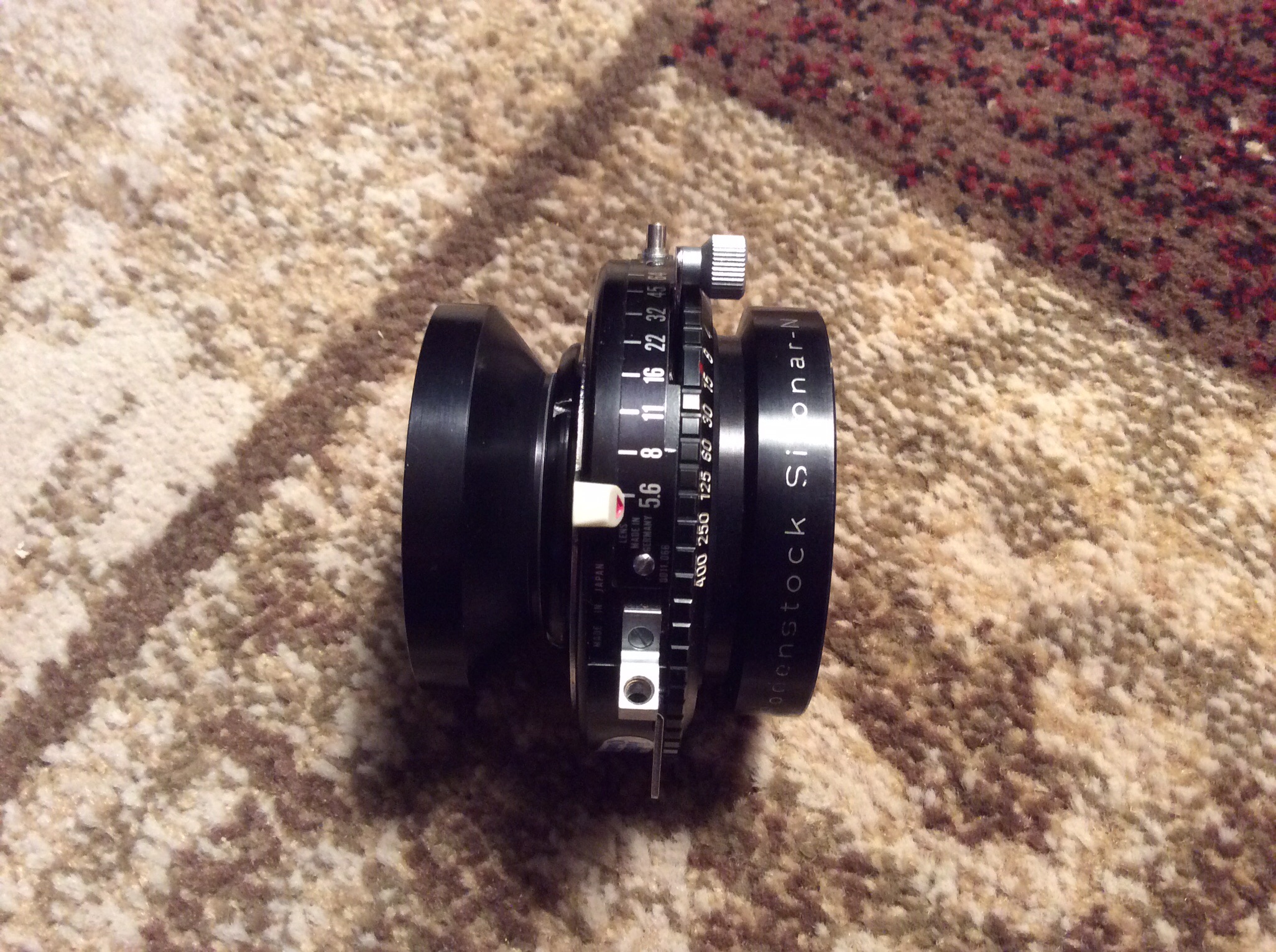

Here's a shot of the lens:
John Koehrer
Apr 3, 2004
8,277
Aurora, Il
Try this:
Mount the lens and measure from the GG to the front standard. Close is good enough.
Adjust focus until it seems sharp, then loosen the front element and while looking at the
GG see if there's any change in the focus. Improvement or no? Improvement suggests a missing shim.
Getting worse? Ahhh nuts! Back it goes.

If your Agfa Ansco still has it's original screen then it'll be quite coarse and harder to use than a modern plain screen, or screen & fresnel. I have 2 10x8 Agfa Ansco's which came with their original screens and with a new screen can now focus a 151mm f16 Ross WA (Protar).
Have you used the lens before, if not you need to try the lens on a different camera to try and eliminate if it's the lens itself. While it looks ok it's not (as it should) unknown for sellers to put the wrong rear elements on a lens.
