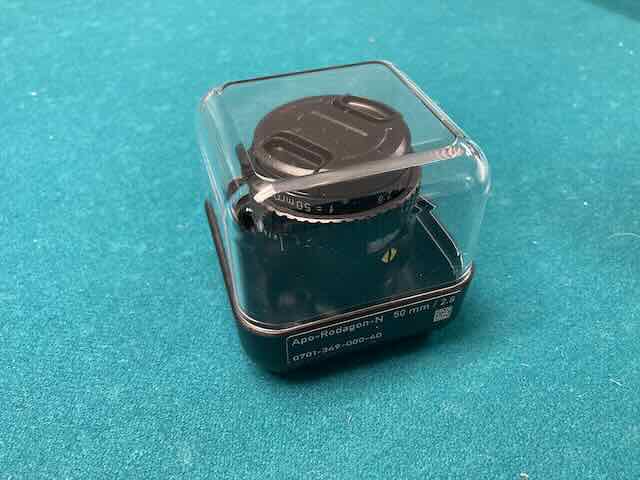

I recently ordered a new Rodenstock Apo Rodagon N 50mm f2.8 from a US supplier. When it arrived today, I was surprised to find that it was in a white box with no branding on the box, no warranty card, and nothing on the lens indicating that it is a Rodenstock. It is simply labeled Apo Rodagon N 50mm f 2.8 on the barrel. It was supplied in a plastic shell, but again the word Rodenstock does not appear anywhere. There is a cheap plastic snap-on lens cap on the front lens element without the Rodenstock brand name. Is this unusual, or is it normal now?

Some further research has indicated that the lens is a Qioptiq Apo Rodagon N 50mm f2.8 lens. It is being marketed in the US by a few suppliers as a Rodenstock. There is nothing on the lens or plastic case to indicate the manufacturer of the lens (either Rodenstock, Linos, or Qioptiq). The white box, created by the US distributer, indicates that it is a Rodenstock. The information brochure put out by Qioptiq describes the lens as a Linos measuring lens developed by Qioptiq. I have not tested the lens. If anyone knows of any comparisons of the recent Linos/Qioptiq lens with the pre 2000 Rodenstock lens, I would appreciate the references. Thanks

The product number on the plastic case is 0701-349-000-40. If you google that number, you will find a number of companies selling the Qioptiq lens as a measuring lens for much less than $1200 USD. I have no idea what a measuring lens is, or how the quality compares to the original Rodenstock production.

Qioptiq is the company that Rodenstock is now part of. It may also be branded 'Linos' because that name still exists for the photo/industrial optics branch in Europe (under Qioptiq). Either way it should be the same lens as before, made at the Munich site. Maybe the packaging policy has got messed up by attempts to remove the 'Rodenstock' brand.
