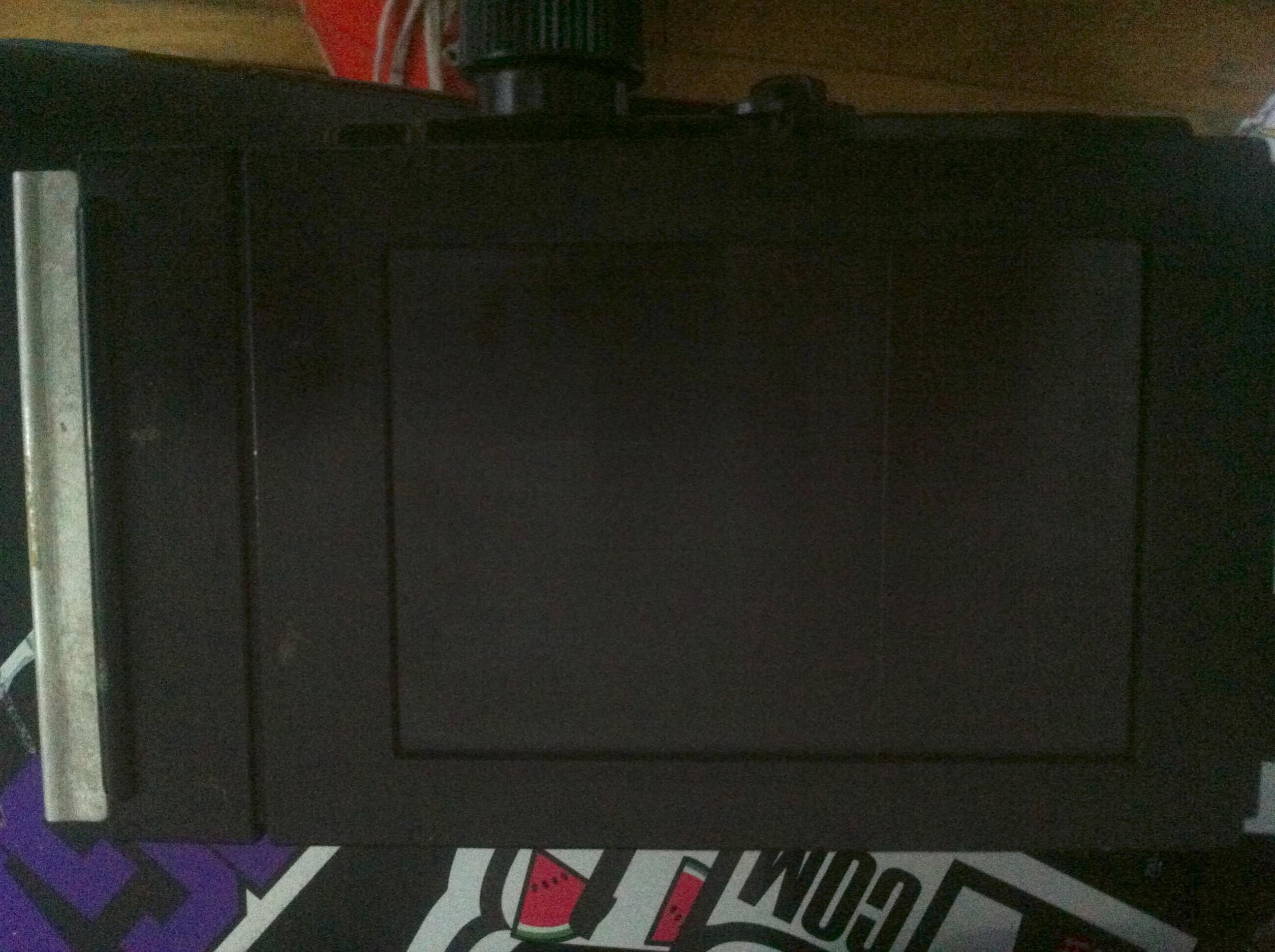

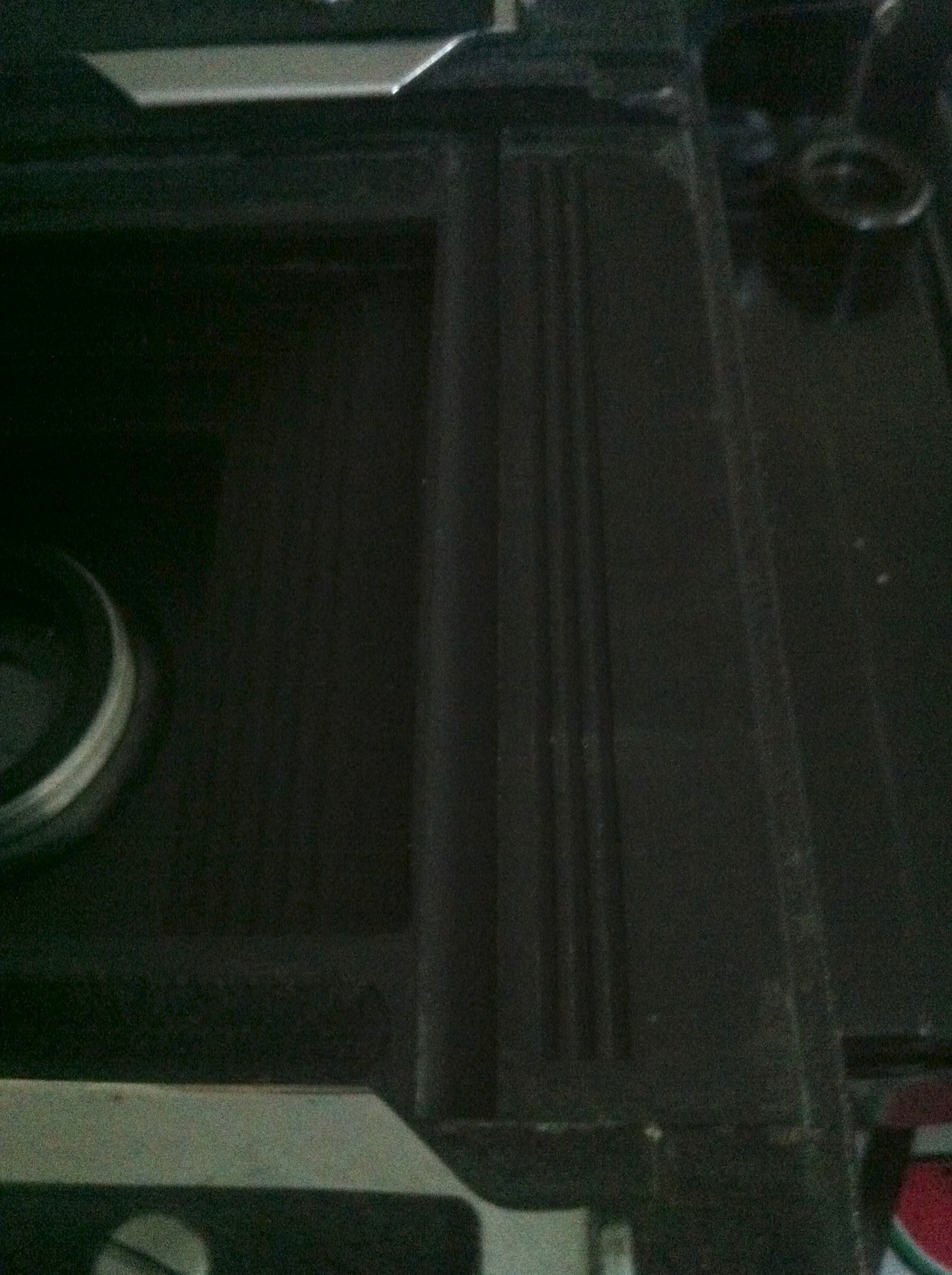

It is a Graflok back. The film back seems to fit securely and snug, minus its ability to shift out on the left side.
Sorry for the crappy cell phone pics. I was being lazy :/

erikg
Feb 10, 2003
1,444
pawtucket rh
That roll film holder looks it's intended for a graflex back, not a graflok, as greywolf suggested. It seems to have a slot, rather than a groove.
Dan Fromm
Mar 23, 2005
6,943
I have both flavors of Graflex-made roll holder, for Graflok and Graflex backs. Erik and greywolf are right. That's a roll holder made to fit a Graflex SLR.

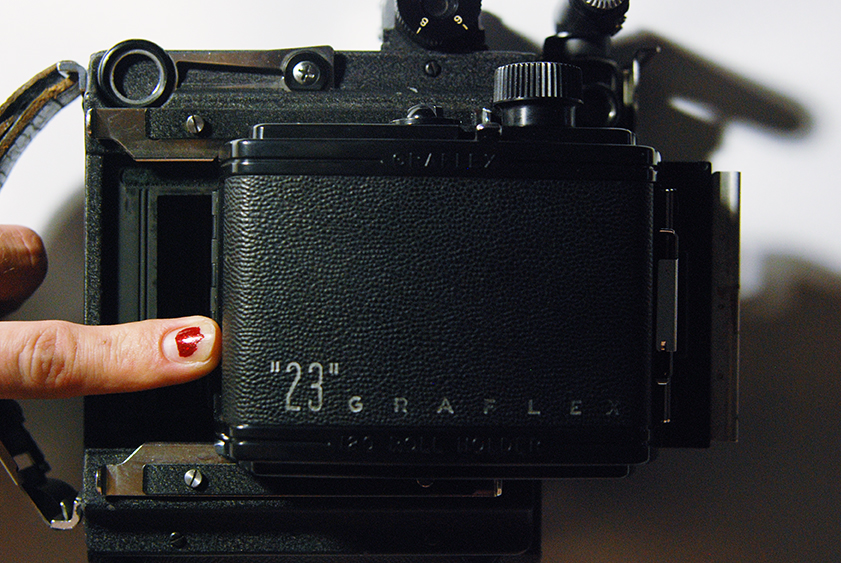

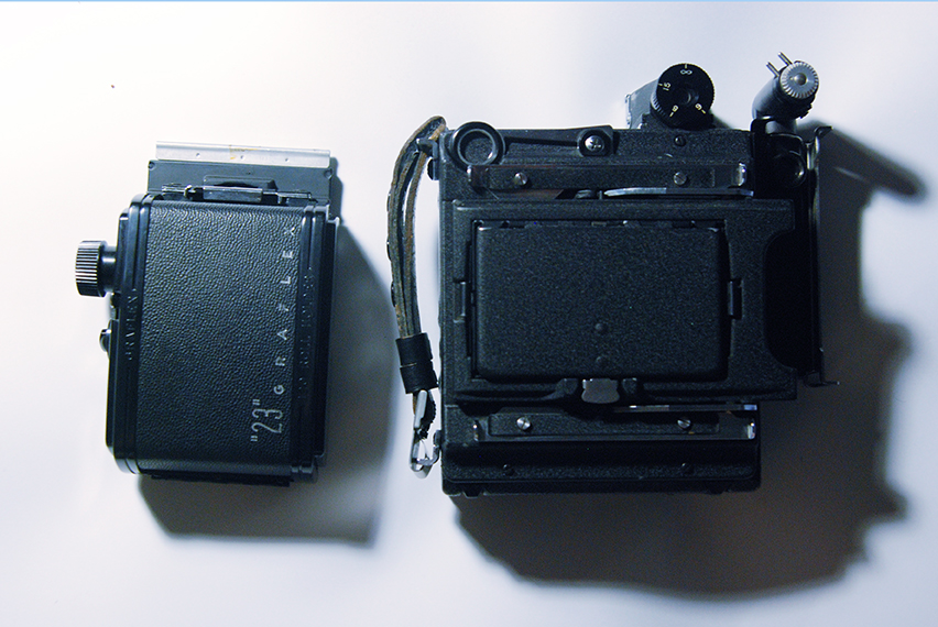

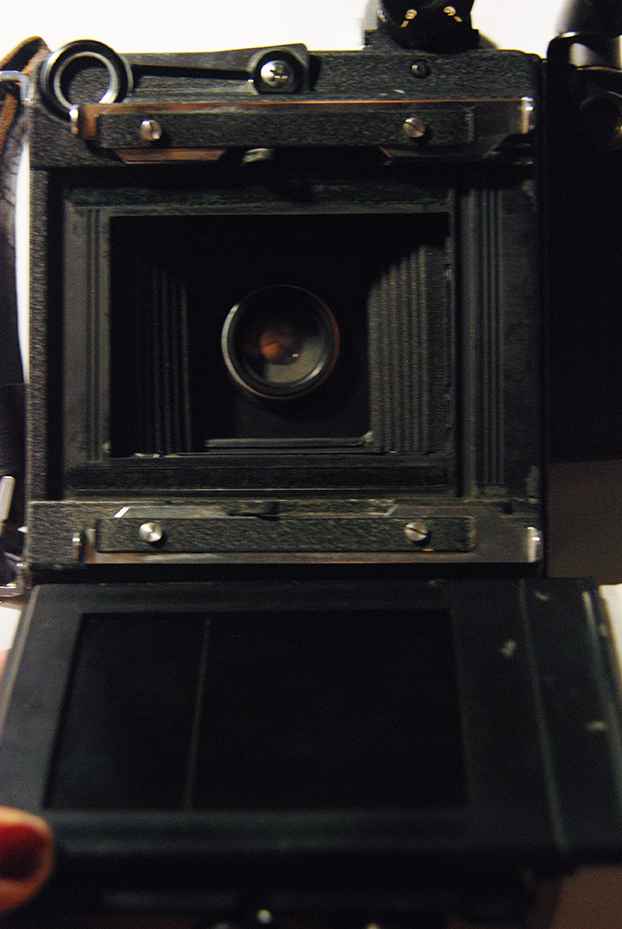

Its a 23 Graflex back.
There's the problem. GRAFLOK back on the camera, and a holder made for cameras with a GRAFLEX back. Did you buy the camera and roll back together?

Dan Fromm
Mar 23, 2005
6,943
John, the problem has been diagnosed correctly. The OP has a roll holder made to attach to a Graflex (as in SLR back) and a camera with a Graflok back.
I just replicated it with a "23" Graflex -- so marked -- back and a 2x3 Crown Graphic that has a Graflok back.
The solution is to buy a "23" Graphic -- so marked -- roll holder or an RH-8 roll holder to fit a 2x3 Graphic. With patience, one can be bought through eBay for a reasonable price.
