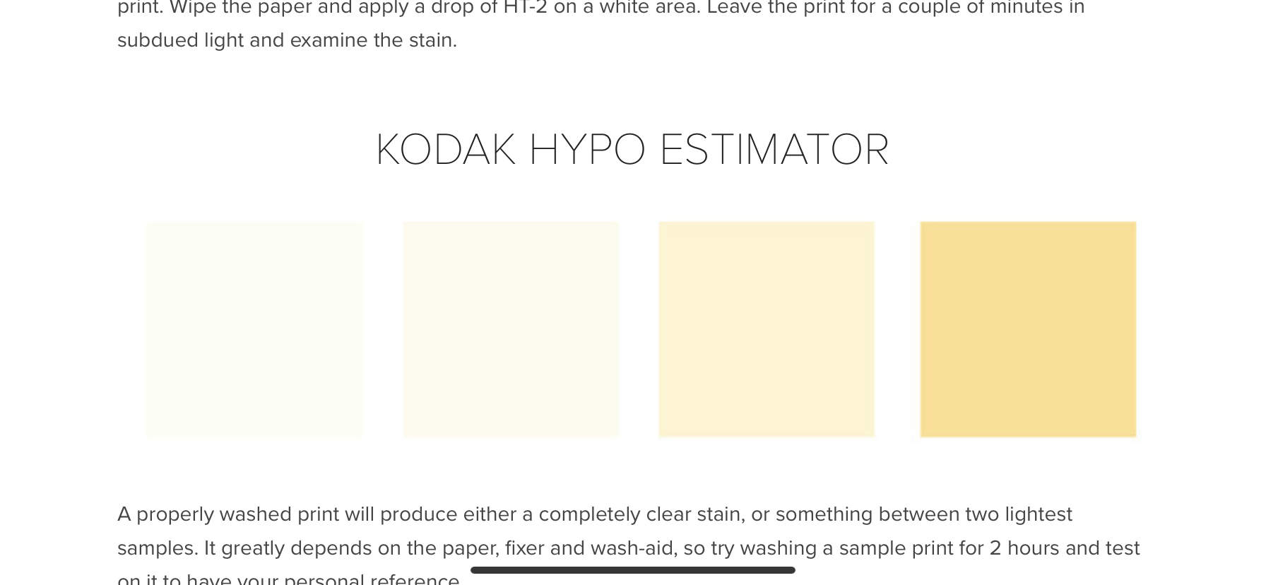

My question: if my prints have a grade-2.5/3 stain (see attached photo for the scale in question), but they are Toned in viradon (polysulfide toner), are the prints well protected?
I’m ambivalent because on one side a toned print will be protected from an frame matboard containing acid, but on the other side if the print itself has some acid left, how can the silver image on which it rests resist it in the long run?
So, what says you, oh experts? Good for 100 years?
The image itself will probably be protected quite OK, but the whites may stain over time due to remaining silver complexes in the paper base or emulsion.
When considering longevity of a print, you have to think about both the image (metallic silver and its desired complexes) and staining of the base & emulsion.

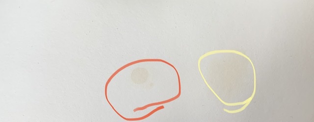

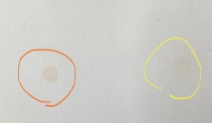

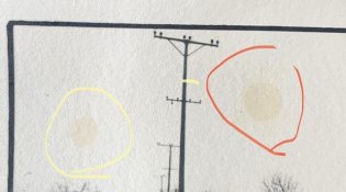

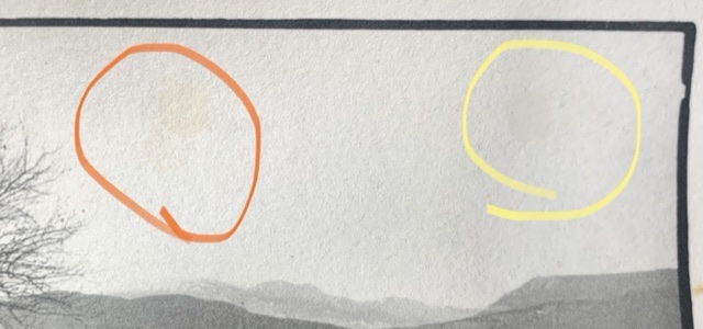

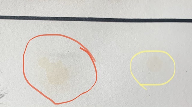

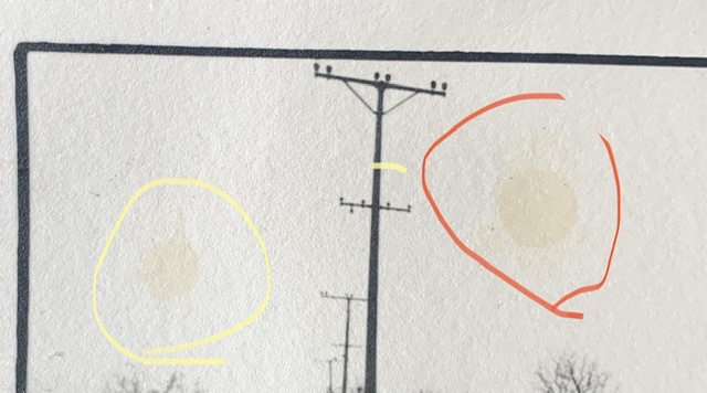

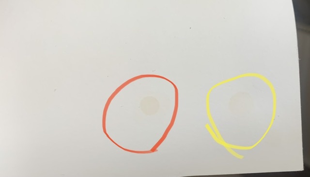

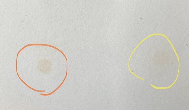

Update:
Dear friends, I am somewhat relieved (but not completely).
It appears indeed that a HT-2 test, done as per the instructions on wet paper, gives results a whole Whopping grade less than when done on a dry photograph.
I am relieved because suddenly my Prints have all jumped from “acceptable” to “Good”, with a few of them now well into the “excellent” category instead of just “Good”, if we go by the HT-2 instructions where the categories are as follows: Excellent, Good, Acceptable, Bad.
However (!) these new upgraded results are a mere result of the HT-2 droplets getting diluted by water on wet paper.
Again, I am ambivalent. While the instructions say that the HT-2 is to be used on wet paper, I will continue to trust the results on dry paper just because it seems to me is the more proper way.
And as a second thought, these results have confirmed that all other fb prints I have spent countless hours on, are indeed even better washed than what I had thought was already perfect.
I am attaching a few test results. Please note that the drop encircled in RED was on a dry part of the print and the YELLOW circle encapsulates a HT-2 droplet done on a wet part of the print. You can clearly see a Whole grade difference or at the very least a Half (1/2) grade.
Please let me know wht you think.

But isn't this precisely why they're supposed to be used on a wet paper, because they've been formulated to be partially diluted by wet paper?
I do not print, I just have been following this thread with great interest and this is just a logical conclusion I am making here.
well... maybe!
Let’s wait for a knowledgeable person that doesn’t have me on his block list to answer :D :D
