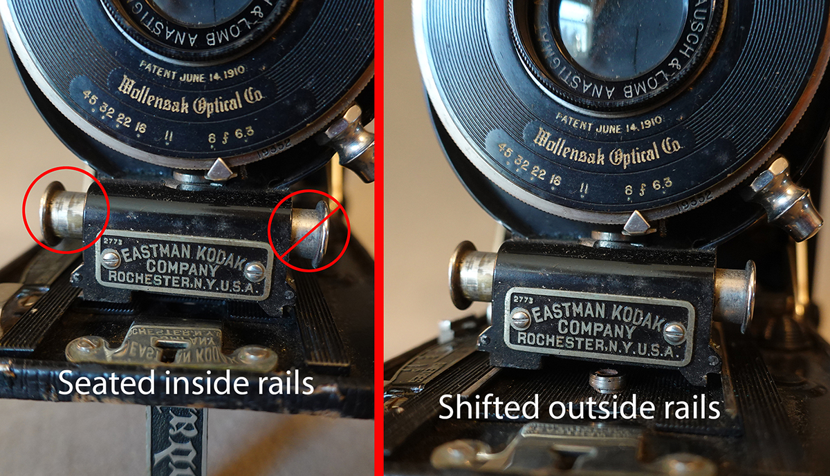

I learned something new since my last post. The lens on my camera was completely "off the rails" after all. I removed some screws and a plate from the front and was able to insert the lens into the correct position. Now it works as it should.

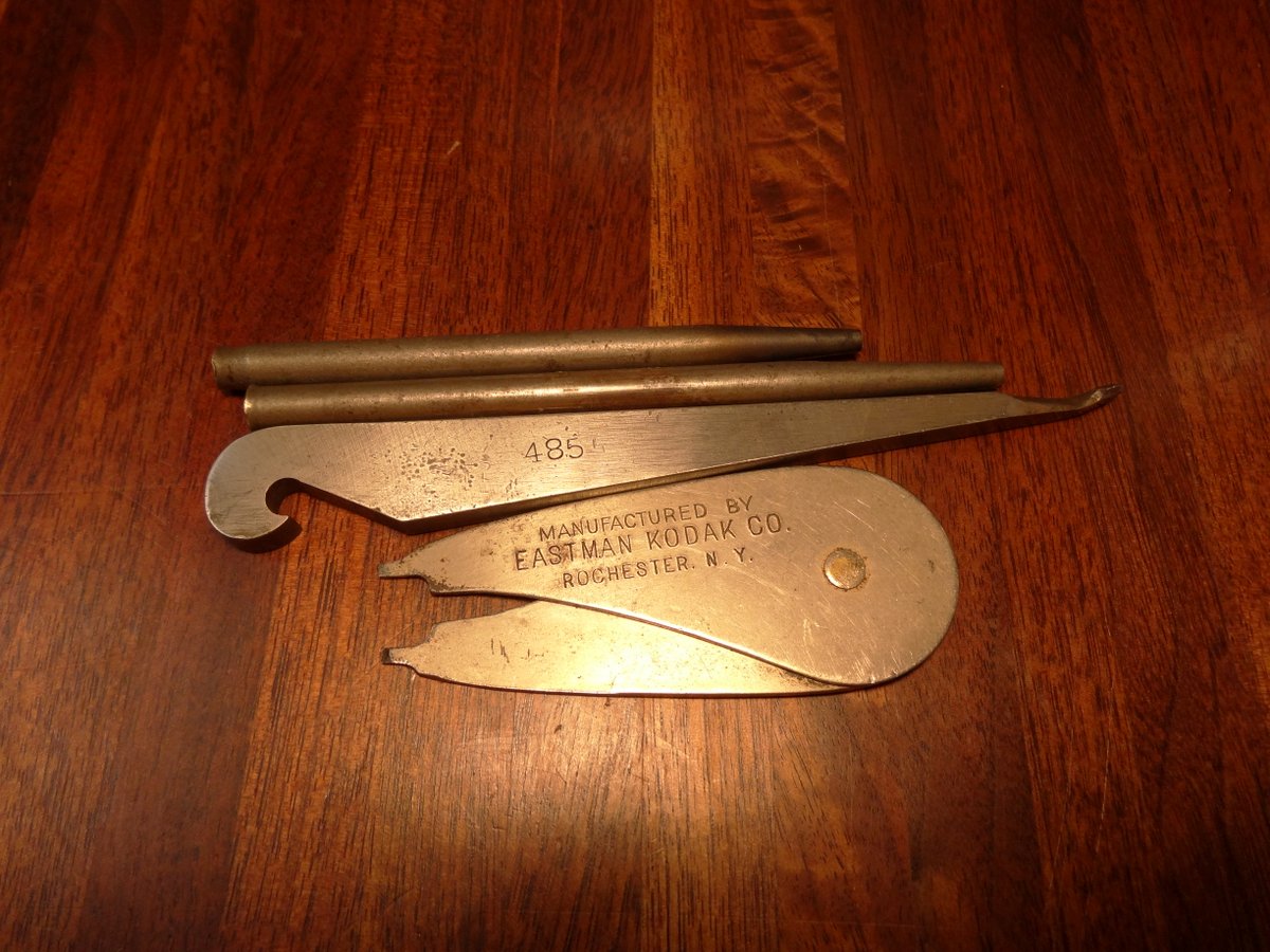

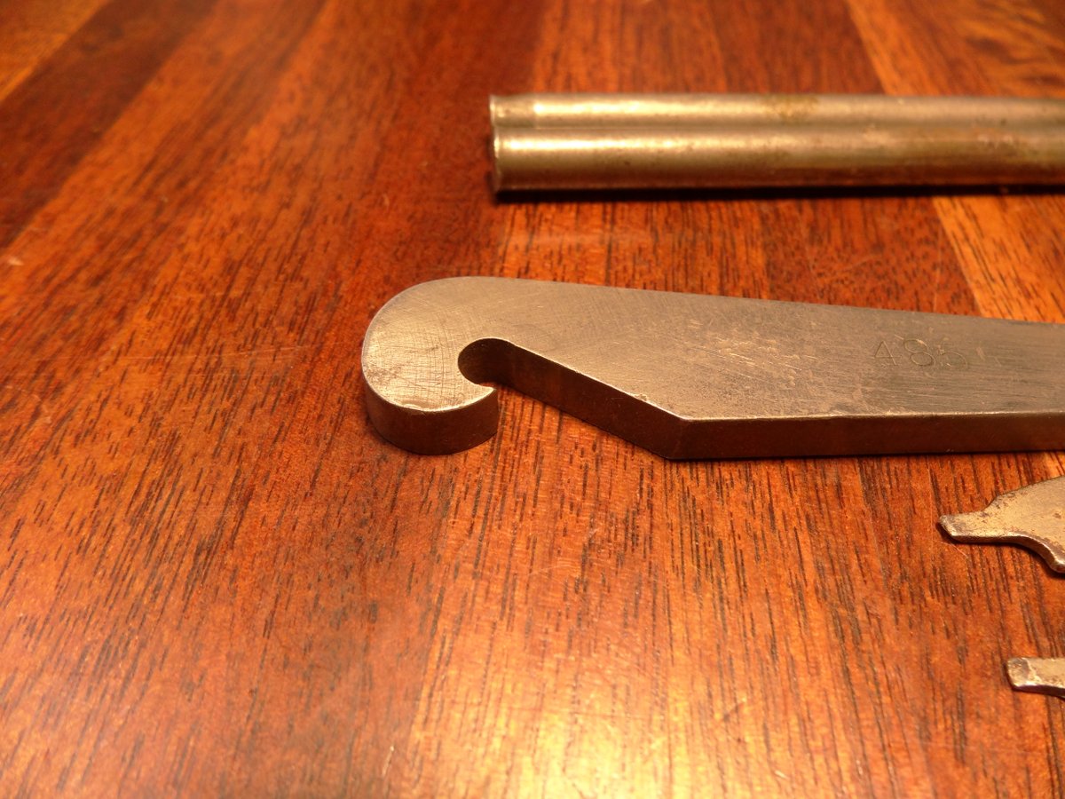

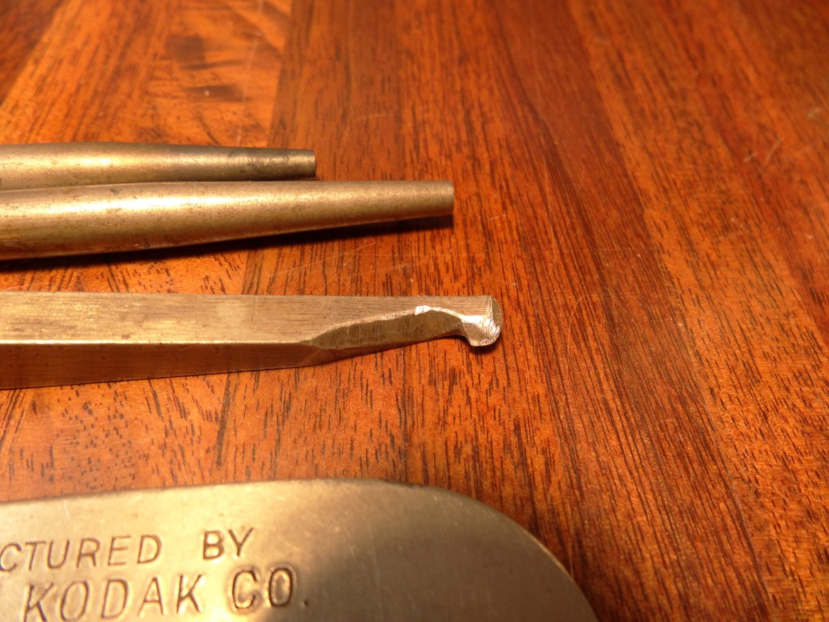

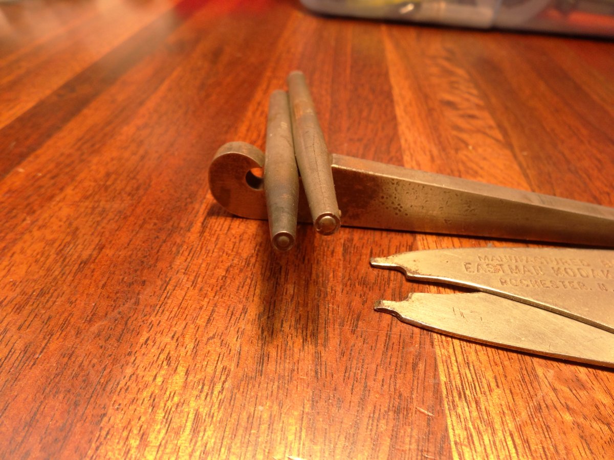

I finally made it back to the cottage and dug my Kodak repair tools out. Here are some pictures of the tool:

Thank you! I figured the tool for the tabs would look something like that. Curious as to the two tools that look like punches or rollers and the flat one. Are those for the tabs as well or something else? The punches almost look like they are for setting rivets. I used to be an auto technician so no stranger to special tools made for specific jobs. They turn what can be a miserable job to do into a joy. There can’t be too many of those out there as I’m sure people had no idea what they would be for and recycled them. That or they got used for other purposes a now no longer do what they were made for. Looks like the tab prying tool should be easy enough to have one made. it looks like its about 5” long? I don’t have the bellows yet, hopefully by end of next week. Thank you again.

Looking at them again. The flat tool looks like it is for loosening the lock ring for the camera shutter. I am more convinced that the other tools are for rivets as newer cameras used rivets to secure the bellows to the front standard and did away with the for screws used before.
Yes, the two punch like tools are rivet setters. Some Kodak folders used rivets to secure a bellows plate to the front standard. The other tool is a small spanner type tool for things like lens retaining rings and such. I think you are right about the unknown tools being thrown in the trash. I'm pretty sure when I croak that's what will happen to these as nobody in my family knows or cares anything about my precious toys.
