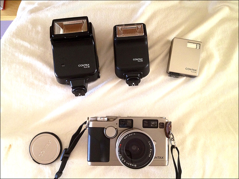

Buy a nice used TLA-20 or better a 30. Both work great on my G2. A little more bulky but worth it. And both will do TTL. That said the TLA 140 works great, is more compact, and matches the G2 titanium body, if that's important to you.

Just took this quick shot with my iPhone. Might help you some. The TLA30 has a head that rotates on the up and down, definitely the most off-balance on the G2 of the group but my favorite.

Heck, you could even get a TLA 280 for $19 at KEH. It has bounce, a zoom head (manual zoom, but still) and even has a secondary fill-flash head and second-curtain sync capability. It's similar in size and weight to the TLA 30. I recently got one for my RTS III. While I doubt the SB600 would fry the electronics of the G2 (iirc, the SB600 is meant for use on digital cameras as well as film, so it probably has a lower trigger voltage), it would NOT be TTL with the G2 - you'd have a manual flash with it. May as well shoot a Vivitar 283 at that point. Which isn't a half-bad option because of the power a 283 packs.

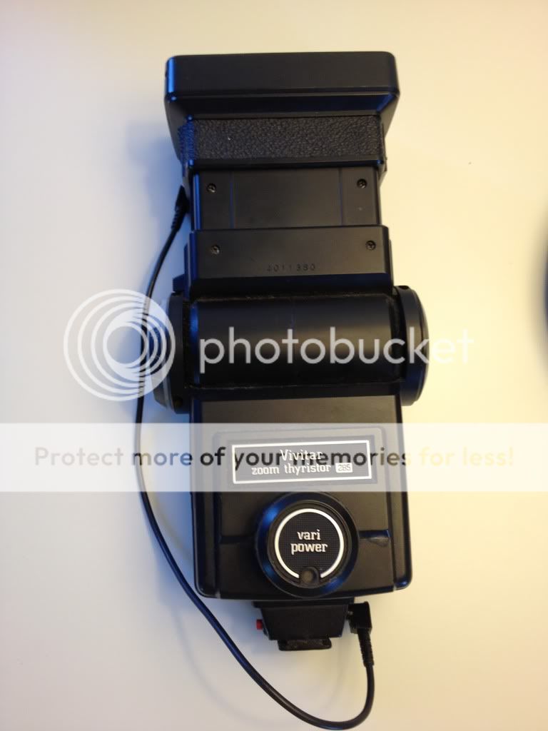

I have this too (Vivitar 285):
