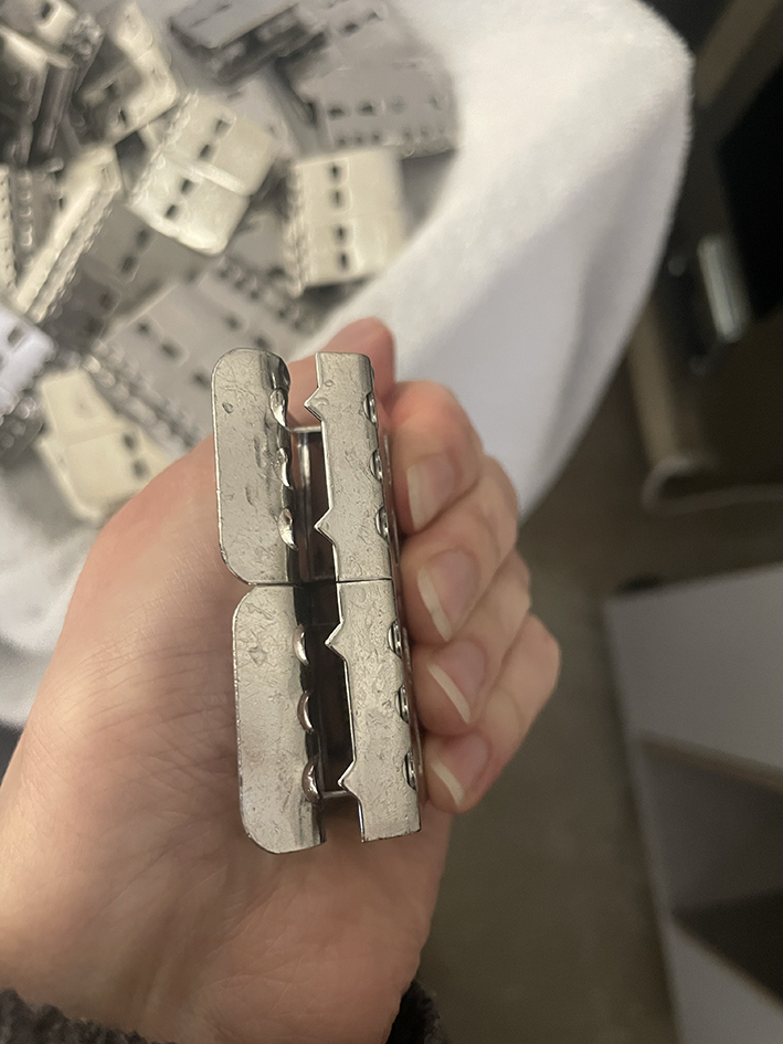

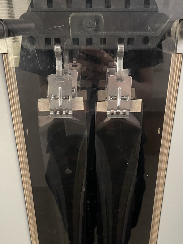

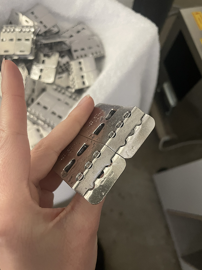

I have a question regarding film curviness, particularly with 120. After the drying process, the film ends tend to curl significantly. I am currently using the clamps shown in the attached photo, but they don’t always keep the film flat. As a result, the films sometimes have trouble passing through the Phase One scanner.
I am exploring other clamp options, but for now, these are what I have available. Do you have any tips or recommended methods for flattening film after the drying process? Ideally, the method should be safe for the emulsion and relatively quick, as we sometimes need to scan large volumes of film on the same day.
Thank you kindly for your guidance.

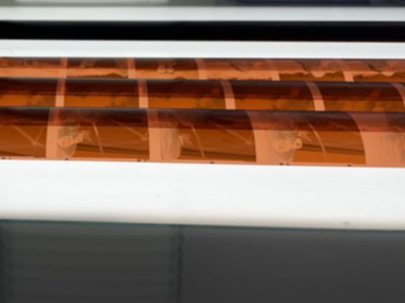

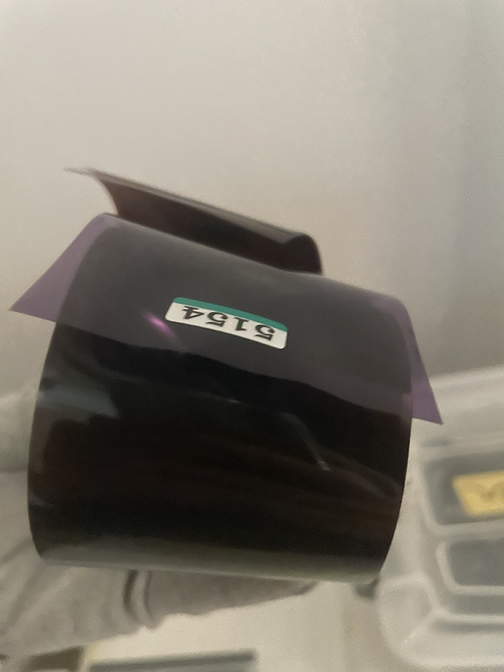

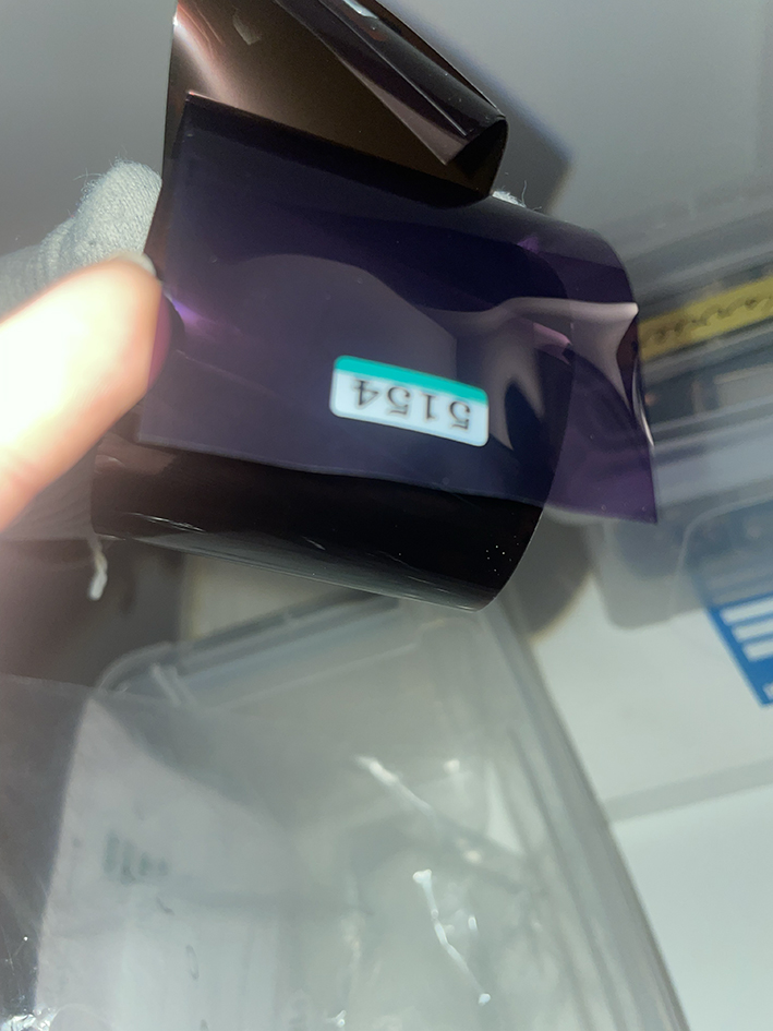

I was also wondering whether the way the 120 films are attached to the rack could influence the curvature in any way. When they come out of the dryer (after the D&D machine process - the machine is connected to the dryer), the emulsion is facing outward.
Should I try having the emulsion facing inward instead? Because, aside from the curves created by the clamps, there’s sometimes a strong curl in the film itself.
I’ll attach photos below to make it easier to understand what I’m talking about.
