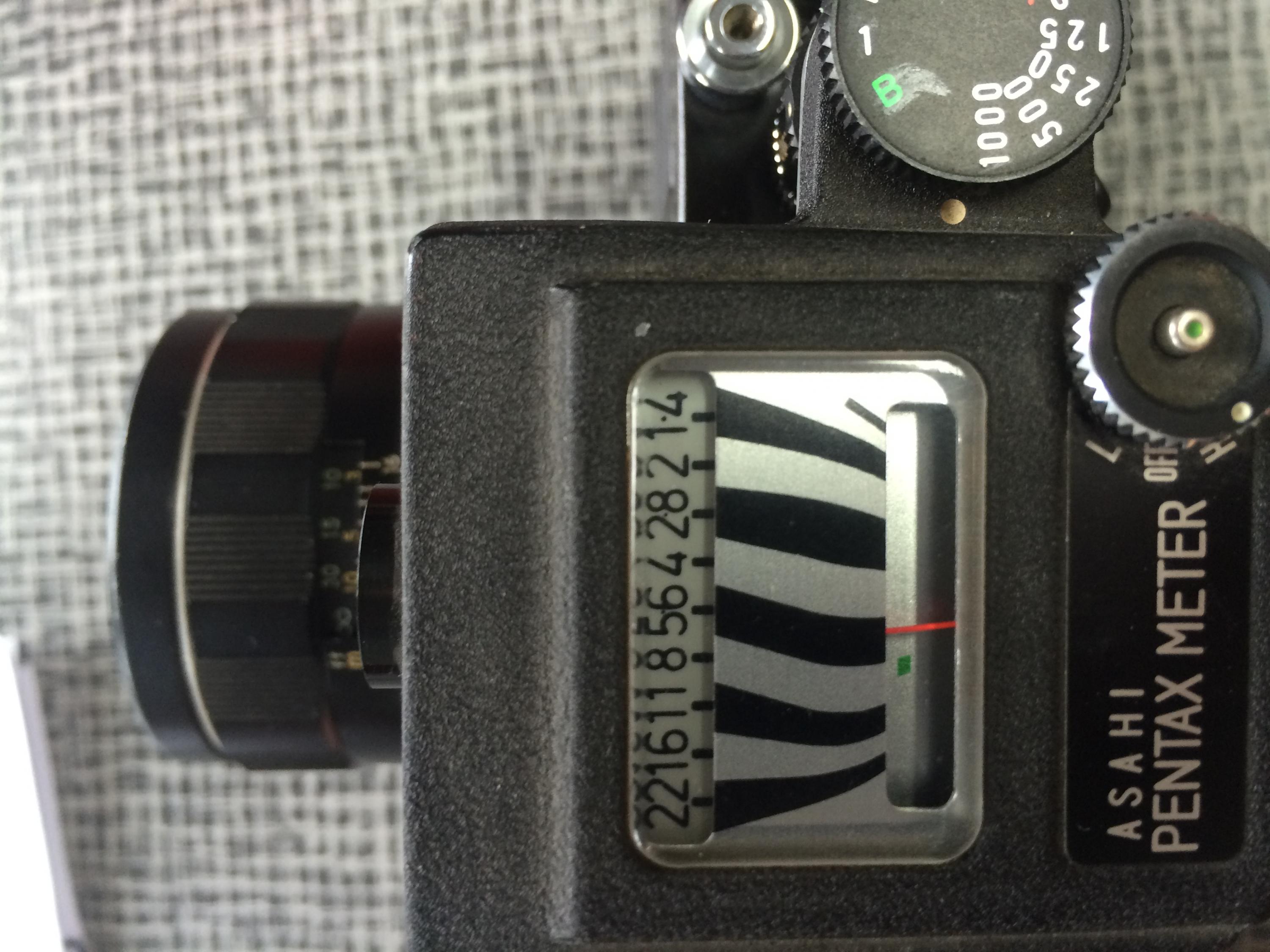

I wonder how I must read this ?
1) f8 - follow the needle
2) F5.6 - follow the shape of the (strange) black line
Thank you !

I have this manual, but I could not filter it out from the description, that is why I ask on APUG

I haven't used this meter but after reading the manual and looking at the photo 5.6 it's in the black area. Judging from the photo not sure where you're getting f 8 . as an aside it looks like the photo was taken inside and the meter should be set to L instead of H for a correct reading.
f1.4 - black band. f2 - white band (or silver, hard to tell on my monitor). f2.8 - black, f4 - white, etc.
f1.4, red needle in black band area. f2, red needle in white band area (or silver, hard to tell on my monitor). f2.8 - black, f4 - white, etc.
Those lines only act as intermediaries to bridge the gap between the small needle range and and the wider range to yield readable figures.
for instance in your sample:
f8 a silver line
f5.6 a black line
There are countless meters that employ this kind of read-out.

Never mind. I guess the green mark is battery check and you aren't talking about that.
You were wondering if you should follow the straight line from the needle.
... follow the needle along the black road to f/5.6
What is looking strange? (At least with that "intermidiary" idea in ones mind.)

Think of the black/silver as paths to the correct aperture. The needle points to the path, you follow the path.
Well put. Crooked and narrow is the true path...... Or some such.:whistling:

It isn't just you Henk that was confused. I am/was confused as well. You and I see two things here. A needle that if you extend its direction to the f numbers above, points to f8 and a black line in which the needle rests which goes to f5.6. The line is wavy(?)and our confusion starts). Others' brains are configured differently and their brains may not even try to extend the needle direction so do not see the apparent contradiction that we see.
