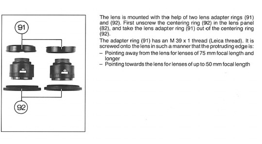

I have a VCP6002(4460) Kaiser enlarger.
I just obtained a nice clean (and inexpensive) Componon-S 80/4 for it ... but being a bit of a dim bulb, I find the Kaiser manual slightly ambiguous about how I should mount it.
In the attached clip from the manual, am I correct in thinking that the image on the right (as we look at the clip) shows how I should orient the adapter ring for 75mm+ lenses (and thus my Componon) ?
After receiving a PM, I realise that had I given this a few moments thought I should have been able to work this out for myself.
so: rhs for 75mm+, lhs for 50mm or less
