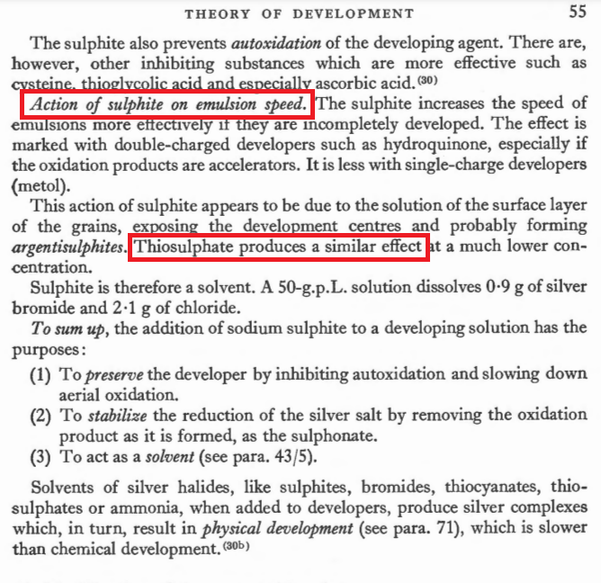

I'm not a chemist, but I can provide you an page from a chemist, P. Glafkides, in his book Photographic Chemistry, Volume 1, page 55, 1958, in the section on the role of sodium sulfite. I hope the information isn't outdated.

Thank you for the replies, I have done many searches, It was conversations between PE, Ian Grant, and Gerald Coch, that peaked my curiosity. I was just trying to get a few grams of sulfite into a PCTEA type developer, to boost shadow speed a little. My first idea didn't work, I have a few other options, but was wondering if a different solvent might achieve similar results. I know i could just add it to the working solutio, n, but I like futsing to keep busy sometimes, I could probably just get T-max to do the same result, but what's the fun in that.
May 28, 2025
9
Plato
Thank you, this implies it is at least plausible. when my film and chems get here I'll try.
